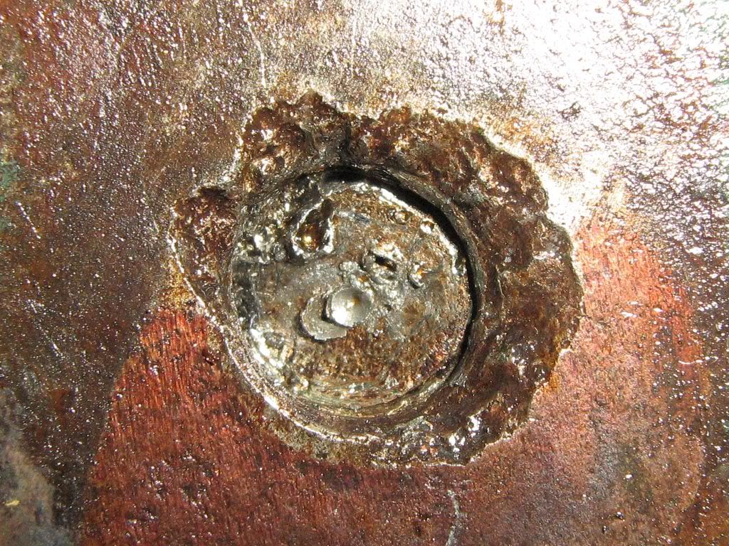

And the answer is:
It was little interesting to do, aside from the fact ALL the work had to be done while hung upside down.
Firstly the centre punch decided to jump when I first set it in place because the end of the bolt was on a slant:
You can see that first dent half hidden behind a second attempt I really only got because of the insane capacities of Dremels.
To be entirely honest, I doubt the job would have been possible without the Dremel. It went down through the bolt like a hot knife through butter - although it annihilated a drill bit in the process.
You can probably tell that the hole wasn't perfect from the first picture, but you try drilling a perfect hole while you're upside down, on a boat that's rocking around and you've got next to no reference for vertical.
Anyway, it was good enough.

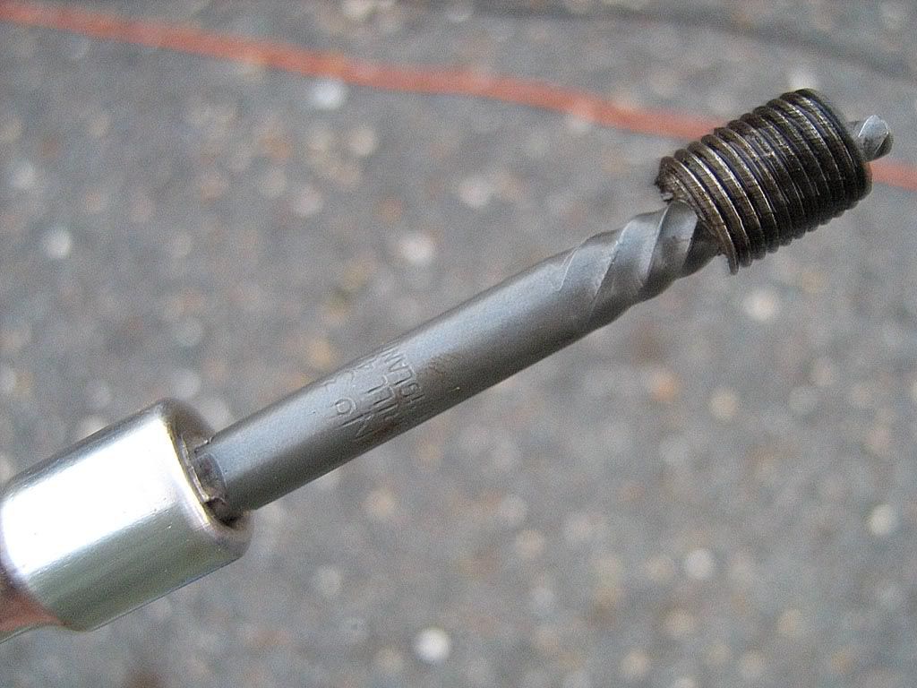

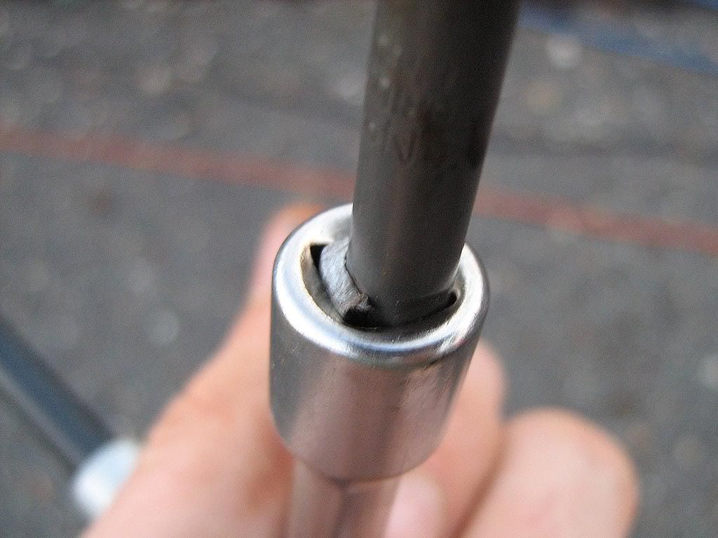

The Dremel also proved a lifesaver when it became clear that there was not the space to swing the tap wrench. One washer and a few cuts later, and I had a temporary adaptor that allowed it to fit into a 1/4" socket extension, which could then fit into the tap wrench and allow it to be driven from 4" further back, allowing it the space necessary:

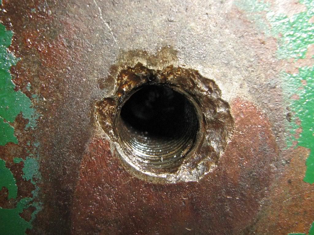

I should note, not a sign of it shifting until the extractor and quite a bit of torque was applied. Certainly no movement while drilling it.
So anyway, job done. Here's hoping it's a long time until I have to do such a demanding, cramped and physically unpleasant task again.
