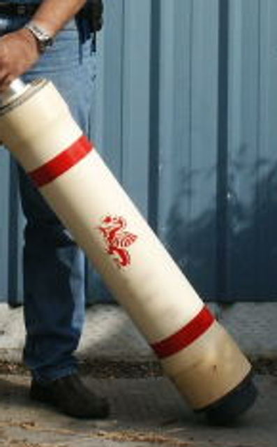

I found the opposite to be true regarding chambers in metal vs PVC. I have 2 cannons with about the same chamber size. My dragon is a couple feet of 6 inch sched 40 PVC with a 2.5 inch coaxial barrel. The breech reducer is schedule 80 to reduce to 4 inch then reduce again with a 3 inch female adapter with a short length of 3 inch pipe for the 3 inch piston. It is immensely heavy.

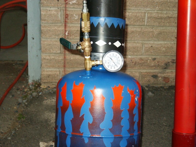

If I used sched 40 Iron pipe and duplicated it, I agree that it would have been very heavy. On the other hand my 2 inch cannon uses a very thin disposable freon tank for the chamber. The pressure rating for both is nearly the same, but the 3 gallon cannon is much lighter and not nearly as brittle.
The steel one was less expensive to build. I used mostly recycled materials and a free disposable tank.
This metal tank cannon is much lighter.
6 inch tank on the Dragon Cannon.  This is a 2.5 inch coaxial piston cannon.  It is heavy and difficult to hold.
Dragon Tank.jpg (33.29 KiB) Viewed 3065 times
