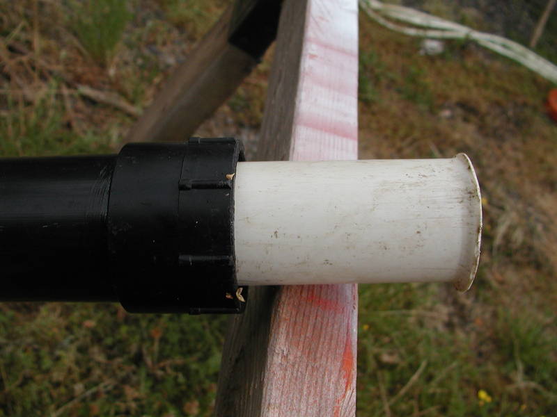

I have, and *sigh* my thread has been clogged up with pointless bickering, just trying to share my creation.

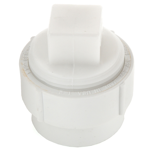

Even something like this glued on the end of the chamber may help retain the barrel. Drill the plug for the barrel and use a threaded female adapter for additional strength with a pip plug instead of the weak clean out cap.
Sorry, most have their hearts in the right place and are trying to help you be successful instead of having another blew apart launcher. We are not trying to laugh and rip your work to shreds. It is not our intent if that is how it appears. I like the design, but having one blow the chamber one way and the barrel the other while you are filling it is the concern. The sport is dangerous. Compressed air has a lot of energy. A cannon going off unexpectedly can cause all kinds of grief.

Using the right glue even an ABS fitting should be stronger than the clamp.  Use the proper transition glue to connect ABS and PVC.
A schedule 40 plug is stronger than a clean out.
Cleanout may reduce the chance of the plug from blowing out.  It has threads.

I like the gun mate, very clean build :). A lot of the guys who have commented on your gun have been around for a long time and generally know what they are on about. It's best to take what they say into consideration and not to heart. Don't let what they say get to you, It's just merely for your own safety.
With what you said about about keeping the gun glue-less so it's easier to repair, the screws would be a great idea. Just 4 or 5 right in font of the plug to prevent a blow out. It's just a nice simple little safety precaution.

I absolutely take considerable consideration about the advice thats given, i was just getting frustrated with pointless non-constructive pedantic-ness that served no purpose.
jackssmirkingrevenge wrote: The discussion of semantics is irrelevant, but the safety advice is for your own good
yeh something like that.
Mitchza89 wrote: With what you said about about keeping the gun glue-less so it's easier to repair, the screws would be a great idea. Just 4 or 5 right in font of the plug to prevent a blow out. It's just a nice simple little safety precaution.
I think this will probaly be what i'll do, but i'll make a wood plug to screw into :)
Thank you for looking out for me so i dont blow my head off :P
