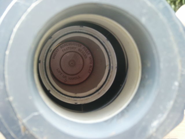

I'm up again. A few comments on the piston. If you have a piston that is difficult to seal, like this one, lapping in the valve is a solution. Make a long piston out of wood dowel that will fit in there and either use fine sandpaper or valve grinding compound and gently rotate the dowel in the valve area (snug fit) to wear the valve sealing face. With a little valve grinding compound on the valve seat then the piston face is mated to the valve seat in the same fashion.
Smaller valve seats are easier to do. Larger seats due to the size of the sealing area are much more critical to complete this step. In the attached photo, this process on the Dragon is shown. Note the sets of black marks on the radius of the valve seat. These are sharpie pen marks. The valve seat was lapped and sanded true to the valve cylinder by use of a piston with a sandpaper face. The seat was sanded until all the sharpie marks wore off evenly. When I started, several wore only a little. I marked often and checked progress until they all wore evenly. It is how I got the dragon to seal. Not the mark on the lower right is completely sanded off. It was my high spot. That is a 2.5 inch valve seat using a 3 inch piston. In the photo you can see one of the marks is worn down more than the rest. This was a high spot that not only provided problems sealing, but put a twist on the piston so it wanted to stick. This may be an issue you are having.

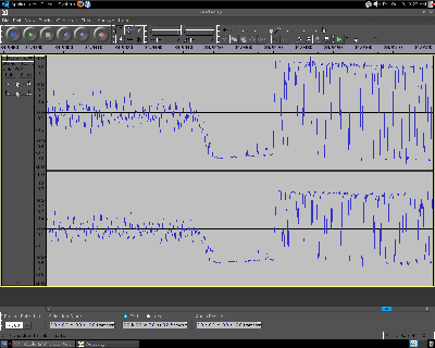

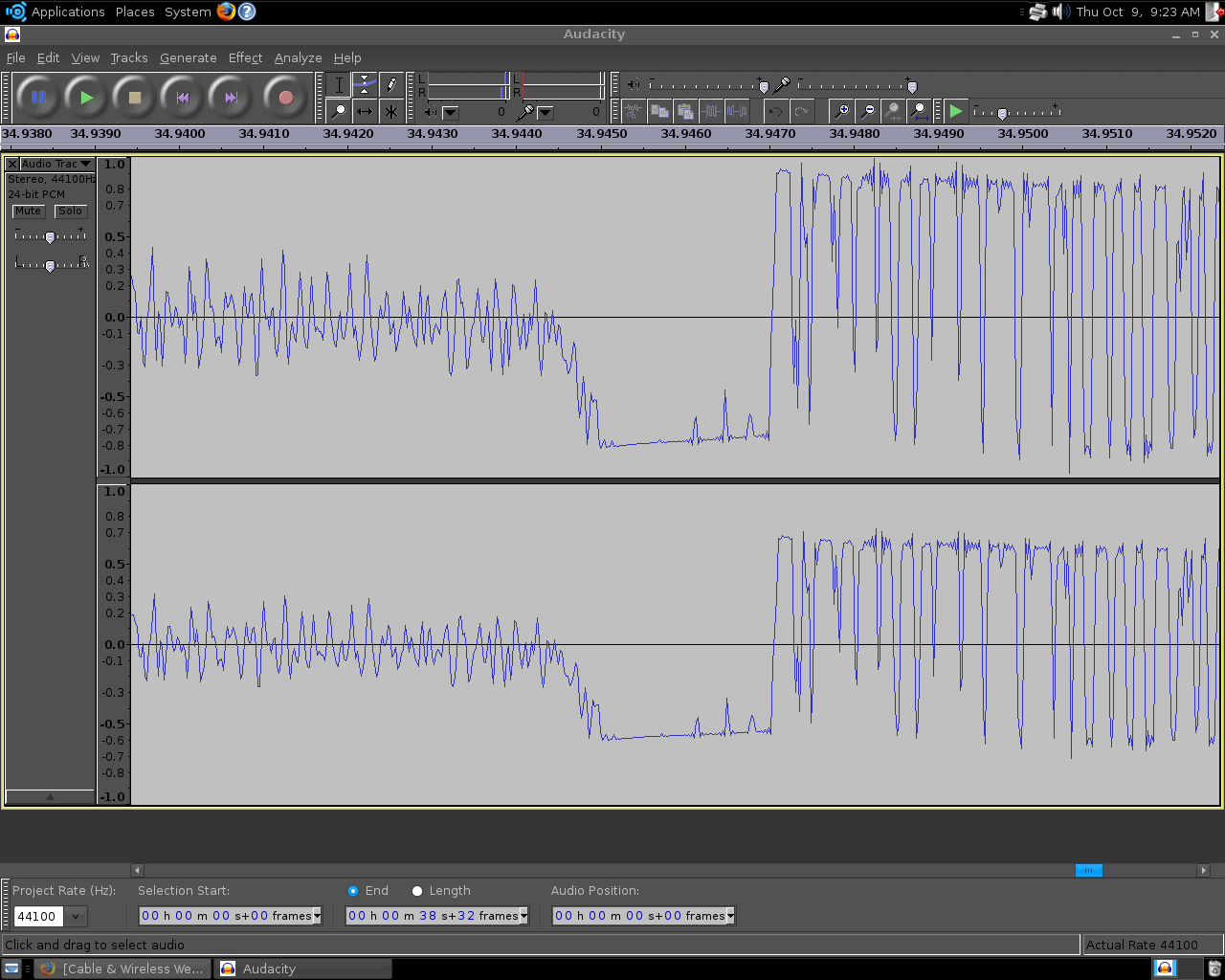

A proper opening valve has the air pressure surge right after the end of the hiss without any hesitation. The second waveform is my Mouse Musket discharge. Note the pressure wave is right after the end of the hiss showing the valve opened fully when it opened.
Am I the only one that can look at a waveform? Help the man out. The wave has been downloaded only 6 times, twice by me.

- Technician1002
- Posts: 5189
The hum is gone. The start of the hiss to the pow is about 0.06 seconds. Nice and fast. The waveform is clipped. The shot is very fast. I can hear the impact, but I too am having trouble seeing it in the waveform. It's fast. The target is hit quickly. I think that the small barrel and high pressure is creating a large high frequency component so the large long step I see with my cannons is not readily visible. Is there a way to turn down the mic a little during recording so the waveform doesn't peak so bad? It is LOUD. Nice sound. I like it.boyntonstu wrote:I tried a piece of thin (~3/16") open cell foam behind the rubber, bubbles.
I hot glued the screw and nut, perfect seal! NO BUBBLES.
4 shots. No bubbles.
This is a shot of 4 ply cotton brief material with marble exposed at 550 psi.
I can't make heads or tails from it.
BoyntonStu
