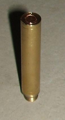

Macro mode was on, but I only saw the photo on the PC after I had sealed everything up. Here, have a properly focused picture of the cartridge curing. Note the canted schrader which still doesn't protrude from the body diameter to facilitate potential future magazine storage ;)

Wouldn't it be expensive to have 10 to 100 shrader valves in your cartridges?
You might need to look into something else... and I just got a great idea:
Push the BB onto the sealing face with a spring, and pressurize the cartridge from the barrel port, so that it acts as a check valve!
Ammo, burst disk AND filling valve in one!

psycix wrote:Wouldn't it be expensive to have 10 to 100 shrader valves in your cartridges?
Not at all ;)
SPG beat you to it;)

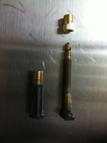

How do you get all that rubber crap off of your schraders, it's always looked like a bit of a pain to me.
Three words, drill, vice, file ;)

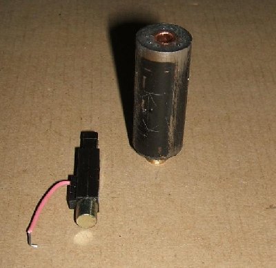

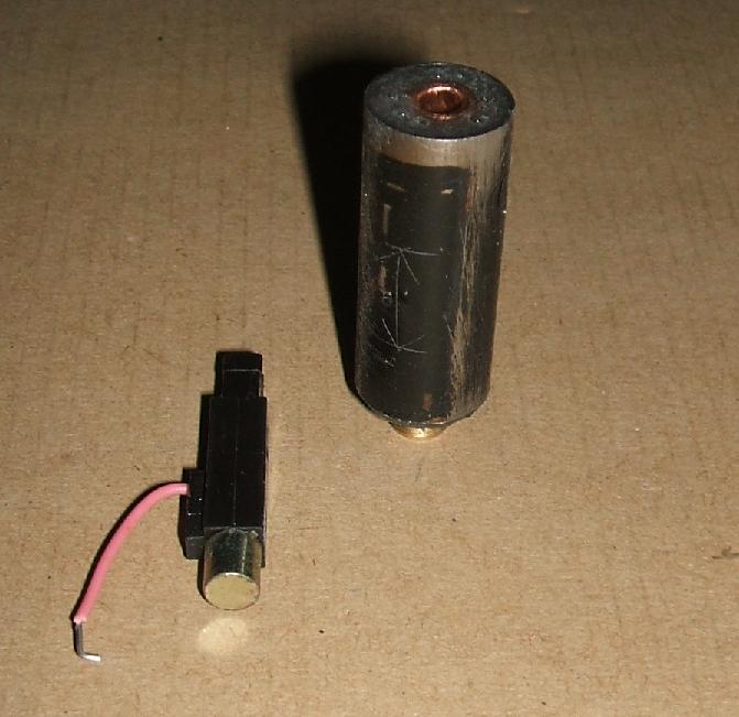

edit: version 2 made and curing, I checked for spark beforehand and it seems consistent :) actual internal volume is only 1.8mL so I'm going to have to be very careful with metering, even at 10x it will be just 0.7mL but with a 1mL syringe it shouldn't be an issue.
update 25/10/2009:
Can't get it to ignite :( I've taken it to 5x, reasonably confident of my metering and I definitely have spark. Bollocks.
Cartridge v2 curing with a piezo ignitor for scale, the scratched arrow markings indicate the effective internal volume.

How did the v.2 prototype perform?
In short, it didn't. I definitely have spark and the BB-seal arrangement is holding pressure, I've tried to up to 5x but no ignition in apparent. To be honest I've chickened out of trying it at high mixes, my conclusion is that I've gone a little too small with the volume to allow for effective syringe metering.
