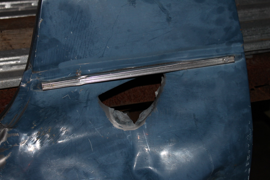

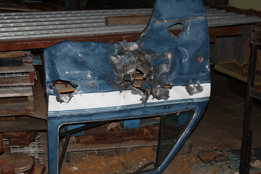

3" compound rounds made it clean through from 15 yards. UHMW compound round video shoot set for tomorrow.
battered after a dozen baseballs, properly vented after 3 shots with one UHMW compound round.

That's some pretty serious penetration for a round that large.

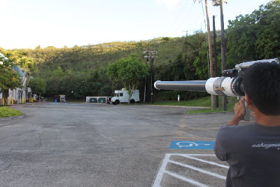

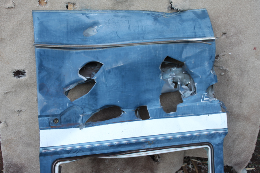

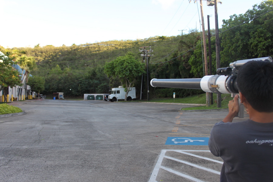

We tested the 630 today at 100 yards and clocked our 440 gram 3" UHMW rounds at 460fps. Although considerably slower than baseballs, we were pleasantly surprised to find only a 36" drop at 100 yards. Target was a 3' x 3' van door and the rounds carried enough energy for good penetration.
Videos processing. here's a couple photos.
check out the white dot at around the 50 yard mark.

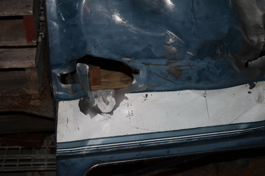

At this size, penetration is more of a tear than formed hole.  yeah, yeah I know what your thinking JSR.

Adrenalin rush.. absolutely. I've been a gun guy my whole life and this is something completely different... like deer slugs on steroids.
The rounds are actually 1/2 caliber CG/CP and based on the same equation as our others.

Also kudos for the firing setup, but since not everyone has a forklift and you've got it to the size where it becomes awkward to aim, wouldn't it be a better isea to provide some sort of bipod attachment?

I hear you on the set up... rear control, bi pod or Hum Vee mount is a must. This is a low cost, proof of concept more than anything.
