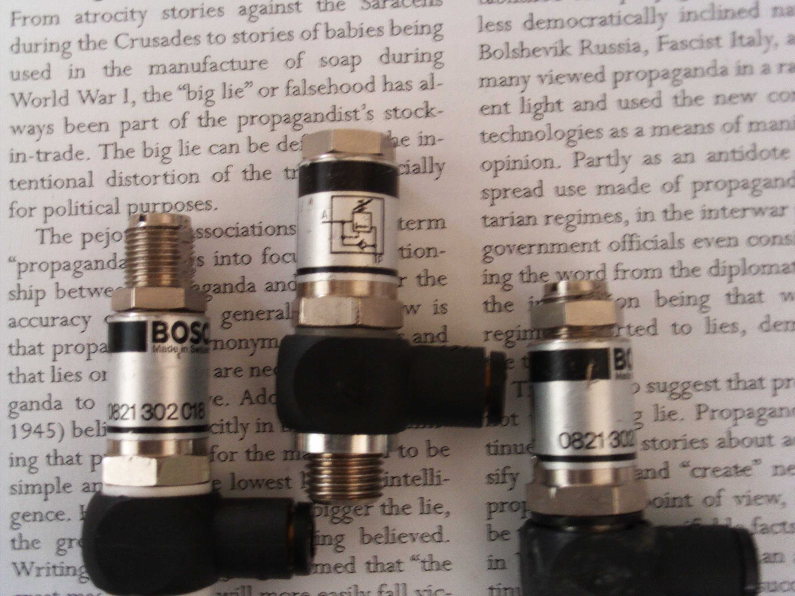

UPDATE
I just got 3 regs for under 5$... they reg down by 0-8bar.. so if you have air at 10 bar you can reg it down to 2 bar... it also has a check valve so when you vent the input side, air from the output side will flow to the input side
they can be cascaded too... so I can reg air by 8 * 3 = 24bar
there are other fittings like that (not just regs): simple one way flow control valves, one way flow control valves with an in built small QEV (so when you vent the input the output is quickly vented via the QEV), and so on
Should we trust such devices in the hands of someone reading about "Propaganda and mass persuasion"
Wait... they reg down by 10-8 bar...
That means that they're just like high resistance check valves or poppoff valves (or crack-open shrader valves)?
So if your input pressure decreases the output pressure decreases as well?
Worth 5 bucks, but rather useless compared to real regulators providing a constant pressure.
The only case I could imagine to use these is to run a pneumatic ram on a lower pressure than the chamber pressure while still directly connecting it, making it more air efficient.
Oh wait. In your case... they seem to be just the thing you need!

@psycix
yeah, exactly..
plus their are really really small when compared with traditional regs
yeah, exactly..
