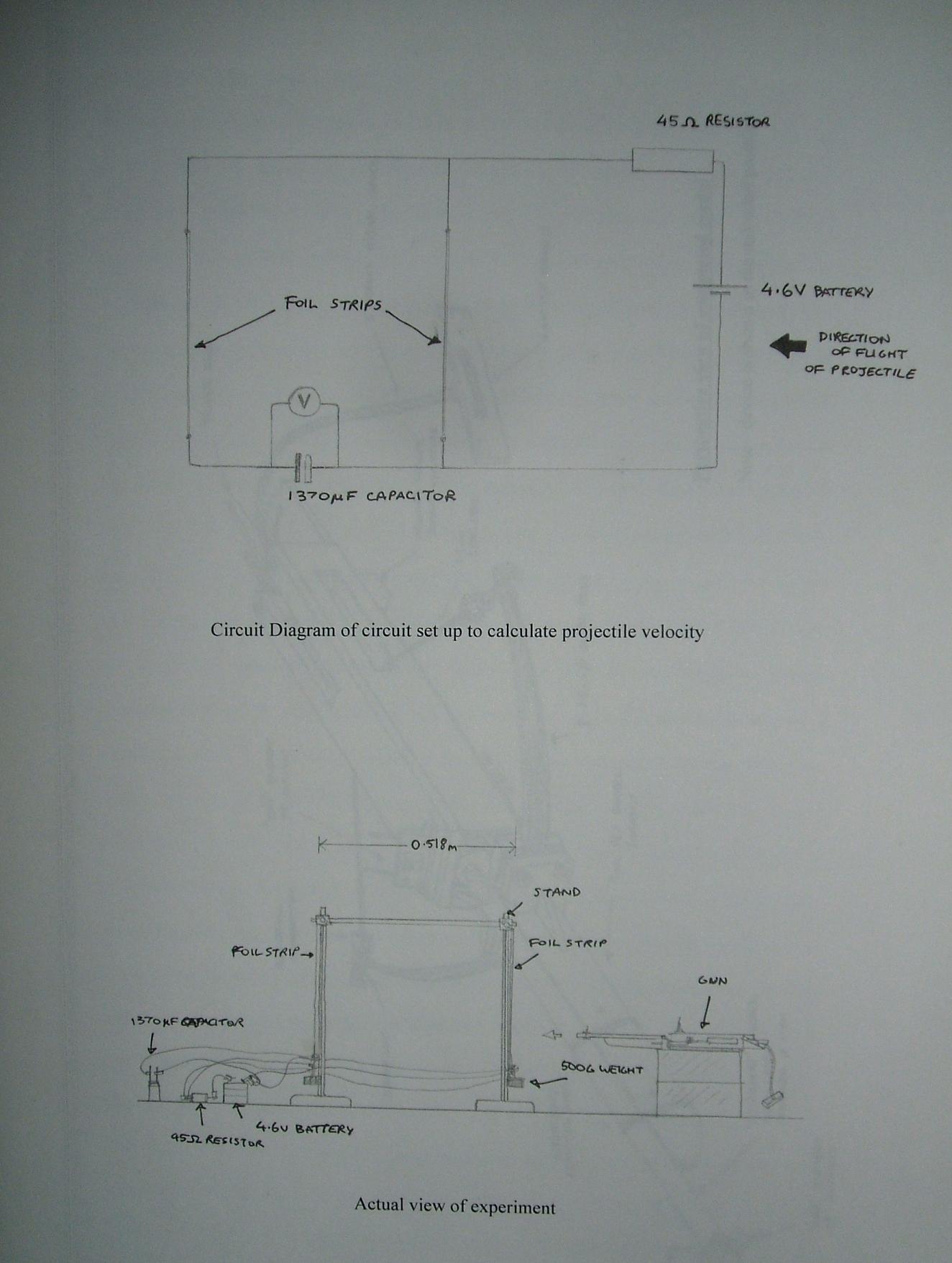

As part of this school project, I had to figure out how calculate velocity in the absence of a chrony, so with the help of my physics mentor came up with the system illustrated below (we happened to be covering capacitors at the time). The time across the two foil strips is calculated as follows:
time = resistance x capacitance x ln(voltage across resistors/initial battery voltage)
I never compared this system to a "proper" chrony but for the launcher being tested I got an average velocity of 30 metres per second which sounds about right.

I've used something similar, although it was set up to discharge rather than charge the capacitor. (Which was also kinder on the batteries running it than a constant short circuit).I never compared this system to a "proper" chrony but for the launcher being tested I got an average velocity of 30 metres per second which sounds about right.

Cute system. I like it!jackssmirkingrevenge wrote:time = resistance x capacitance x ln(voltage across resistors/initial battery voltage)[/b]
I'm curious though... What was the accuracy of your components? At the office we find that such systems often require high precision components to provide meaningful results. I mean, if you plan for a 10 ohm resister and it's really a 12 ohm resister... In most applications it doesn't really matter. But for the app you show, I'm inclined to think it would in fact matter.
Not meant as a jab, just honestly curious. Cool concept.
My concern would more be the capacitor.D_Hall wrote:I mean, if you plan for a 10 ohm resister and it's really a 12 ohm resister...
Resistors may claim 5% tolerance, but mostly, they're 1% or less. Capacitors typically claim more like 20% tolerance, and although I don't test all my capacitors, I tend to find that they're far less precise than the resistors.
Of course, with a decent multimeter, you can check the actual values of both and work with much more precise figures.
No idea, this was done in the equivalent of a high school physics lab so I'm guessing they weren't top of the range components, I don't remember if we had verified the data with a multimeter though.D_Hall wrote:I'm curious though... What was the accuracy of your components?
don't forget leakage in the capacitor!
Thats why I like staying away from those kinds of circuits. When measuring the capacitance of the capacitors, they ranged from 300 uf below to 50 uf above, for 3900uf capacitors (they were surplus though).
