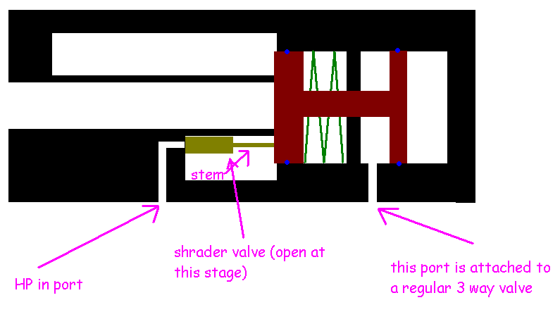

well I've been thinking about this since summer... the fact that there are valves operating on this principle suggests that I might be on the right track...for some reason it does sound vaguely familiar
- this is just to show that there are different possible ways to build a valve that I mentioned... I don't like this design as it's more complicated
- hpvalve-with-hp&lpcircuits.PNG (15.82 KiB) Viewed 5313 times
- I know it would work but IDK how good and how well it owuld work at high pressures... but anyway it pretty much shows you how the valve should function...

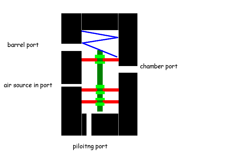

'air source in' is where you attach HP source
chamber port is where you attach the chamber
barrel port is where you attach the barrel
piloting in port is connected to a normally closed push button valve... that's the part that runs on regged down air from HPA source (preferably at just 8 - 10 bar - in this way regular DCV, fittings, and air cylinders could be used)
how it operates:
in normal postion air flows from HPA source to the chamber... .as soon as the pushbutton valve is pressed air flows through the pilot port and the 'spool' moves up closing up the HPA source.... a couple of ms later the air from the chamber rushes through the barrel
as soon as the operator depresses the push button valve it vents air from the piloting side of the valve and the spool returns back to its original position thx to the spring - positive pressure valve.PNG (16.38 KiB) Viewed 5313 times

Poland
IMO the positive pressure valve would be the easiest to build and have the most potential. The ends of the valve body could be redesigned as end plates and attached to butt the ends of the cylinder perimeter using screws. My only concern would be the possible damage caused to the spool seals as they pass the ports (barrel, chamber and source). However, overall I think it's a cleaver design.
