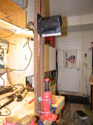

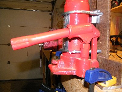

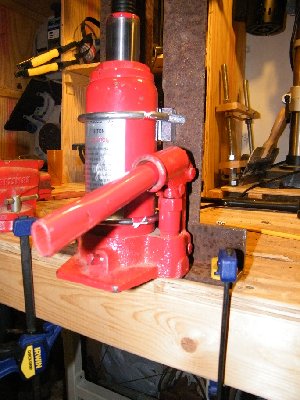

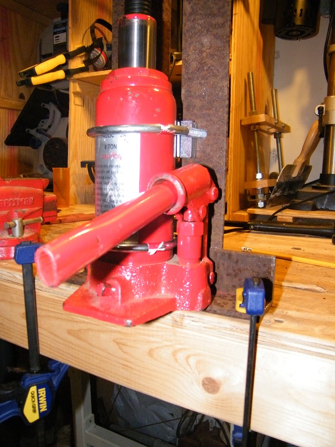

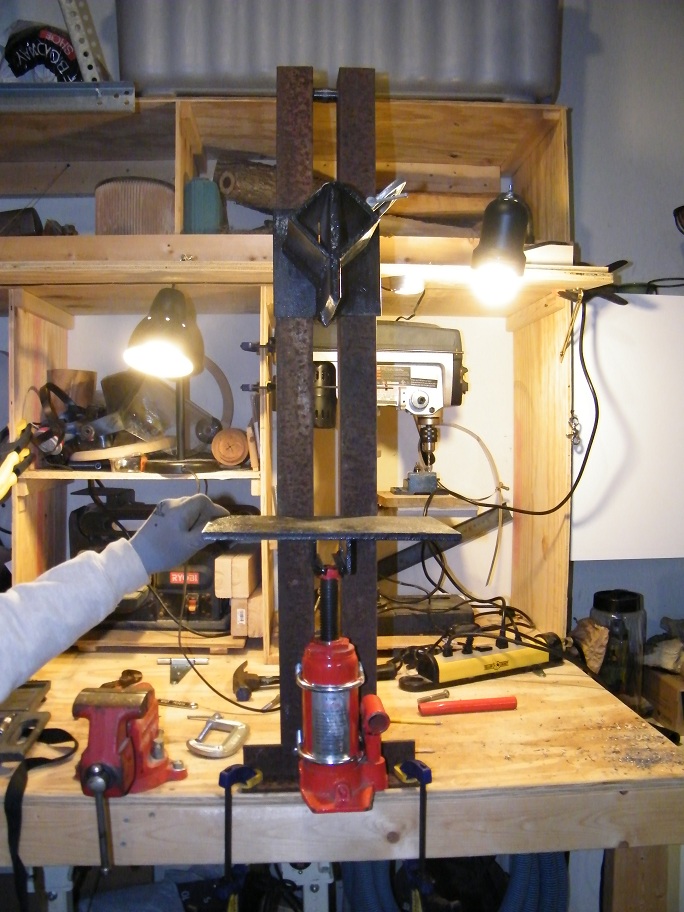

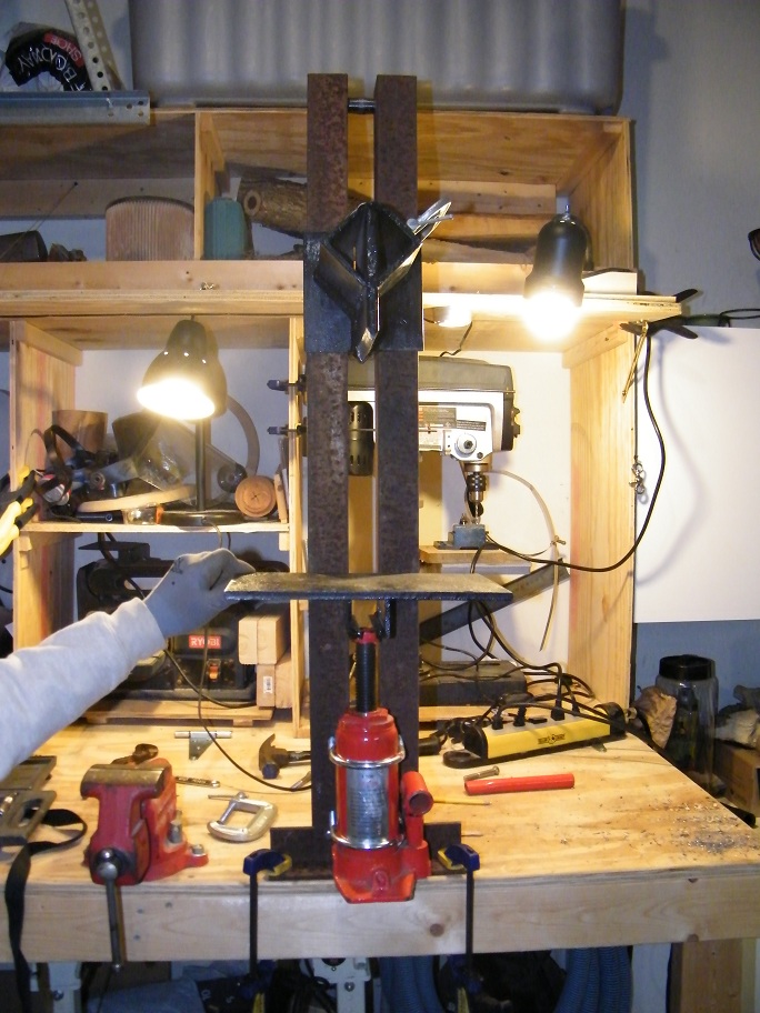

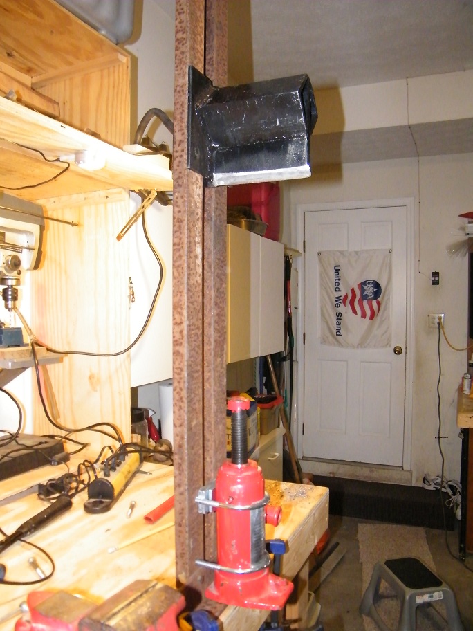

Got pics and a video of what the hydraulic one looks like that my father built... works pretty well. All the clamps and whatnot are temporary just to make sure it works before we do anymore. Eventually it will be adjustable and have a spring foot pedal so its easy to use... kudos to my dad for doubting his idea.... I still think a pneumatic one would be sweet! Think about the speed :twisted:
Here's the video haha:
