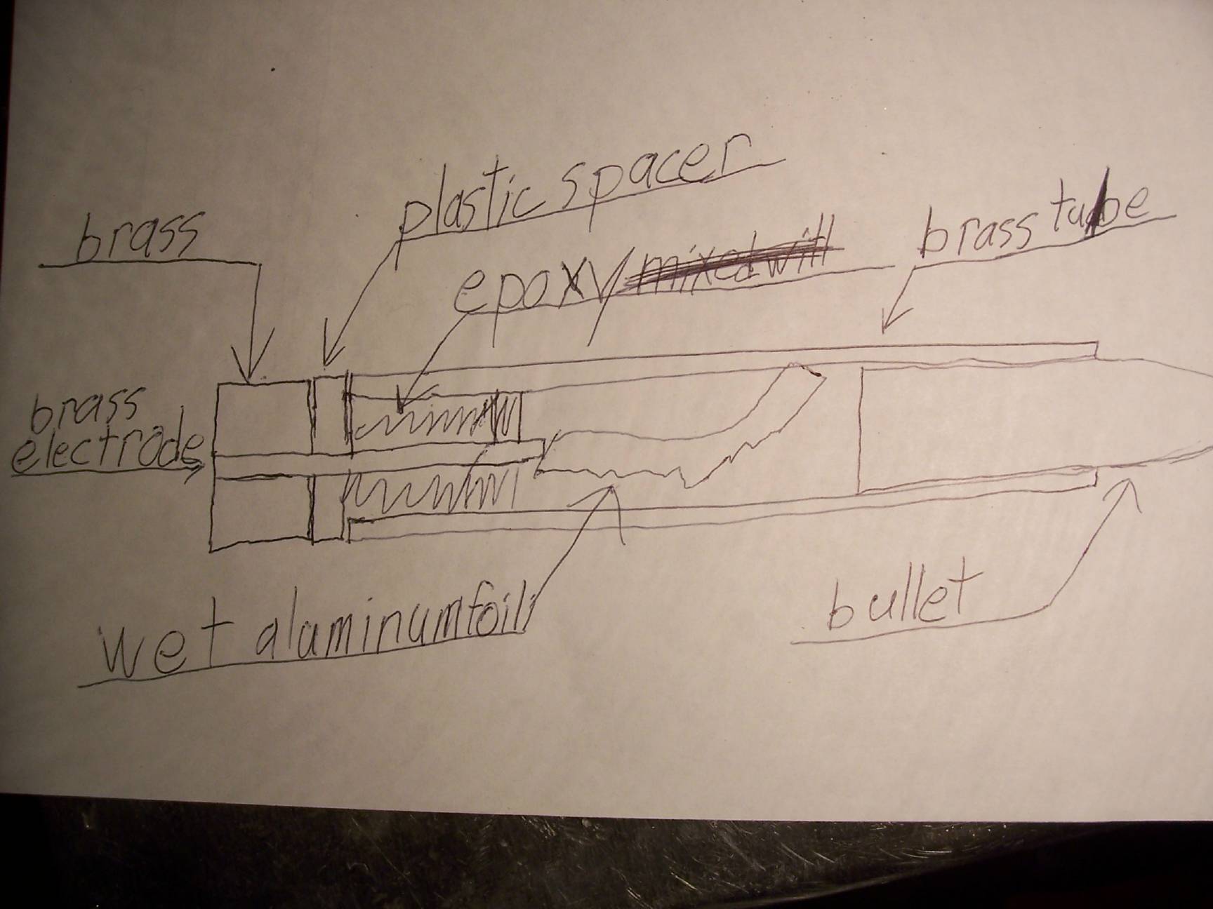

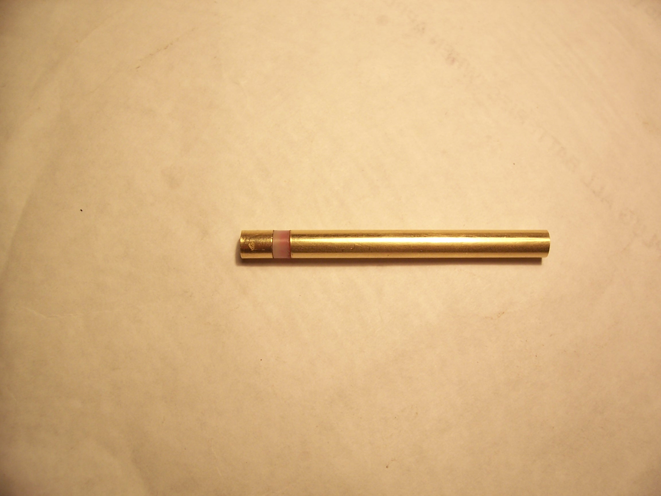

Good work 245Tommy, not many people have this much success on their first try at an ETG.

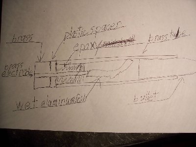

It would be nice to have some more specific details on its operation though; what the propellant gas is, and how it is generated (my best guess based on your design is that you create an arc through the propellant to ablate it) are what I'm most interested in.
Also, it may be worthwhile for you to try a simple ballistic pendulum test to try to measure muzzle speed/energy.
4mm ETG

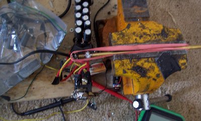

It is interesting that I just dug out my capacitor bank. I was playing with it drawing arcs through a saltwater resistor. Very bright.

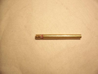

Actually, my first etg used a cut up co2 cartridge as a barrel and chamber, and it worked alright. The propellant is a 5x22mm shred of aluminum foil dipped in water bridging the screw electrode to the barrel.DYI wrote:Good work 245Tommy, not many people have this much success on their first try at an ETG.

In the interests of safety, can I suggest that you please insulate or otherwise protect those bare connections from stray fingers? The voltages and energies you're dealing with could easily cause cardiac arrest if someone (that someone being you, most likely) got a shock off them.
I'm notoriously resistant to electric shocks, as I have abnormally high skin resistance (around two orders of magnitude above the norm, believe it or not), but even I would be wary of what you're doing.

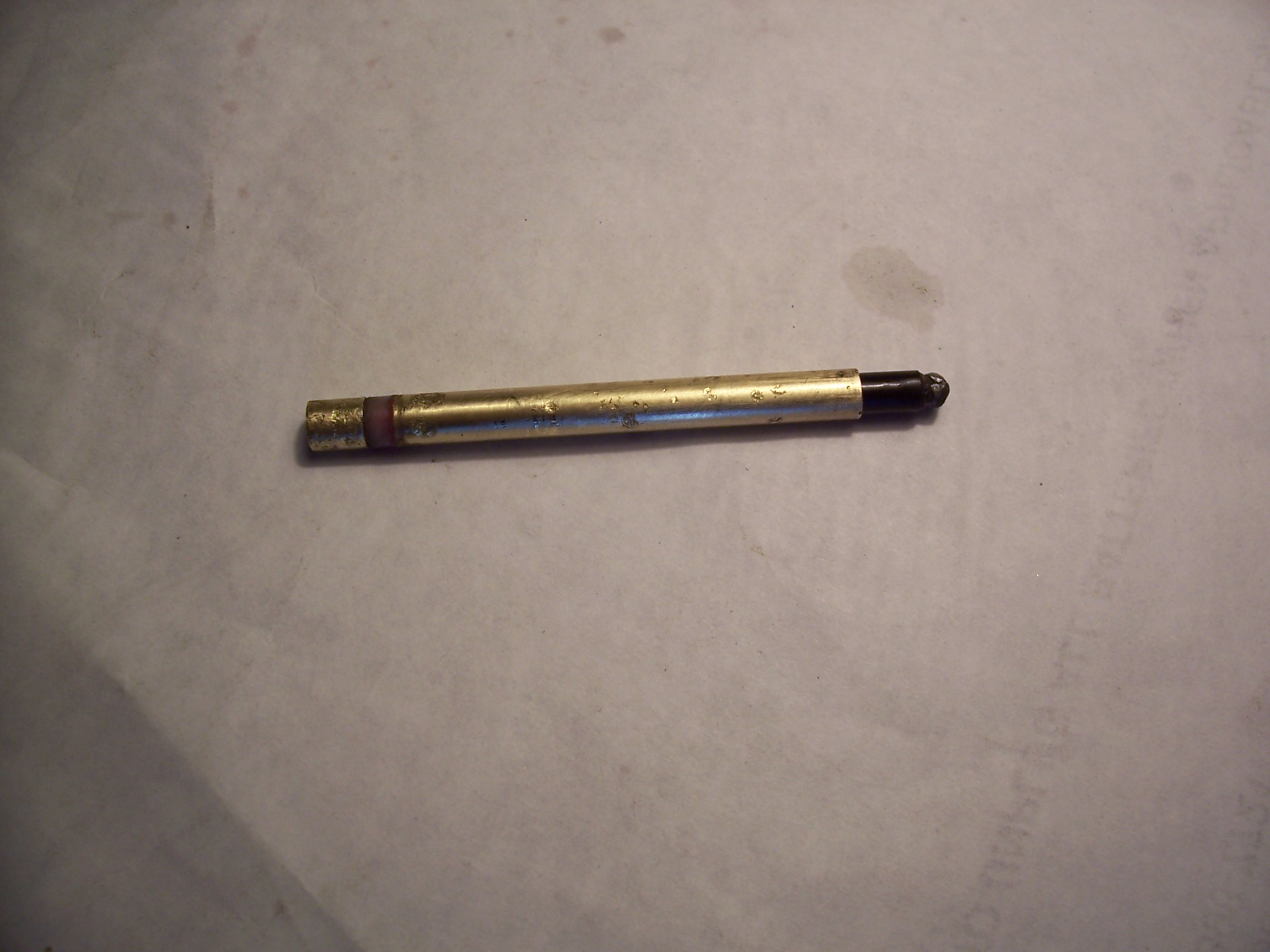

will the cartridge eject or is it a locked breech?

Lookin good. i wanna see the cartridge shoot now
