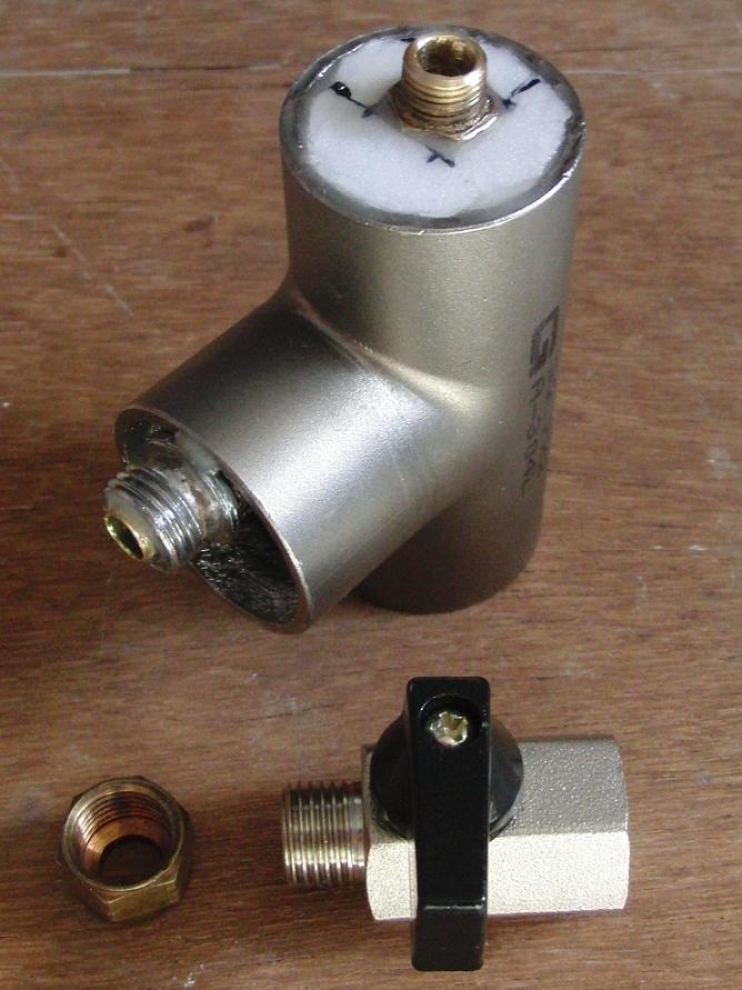

That's basically what I'm going for, however before turning my attention the the trigger I'm going to make the vortex block assembly to see what sort of performance I can get from this.USGF wrote:large model RC servo stuff should work well.

Progress update, the vortex block is being made in a stainless tee, for those who fear it will blow up in my face
still plenty of epoxy but the ball valve and barrel will be threaded on, and the tee itself will thread into one of these to connect to the HPA tank. It will probably be ready for low pressure testing by tomorrow, watch this space

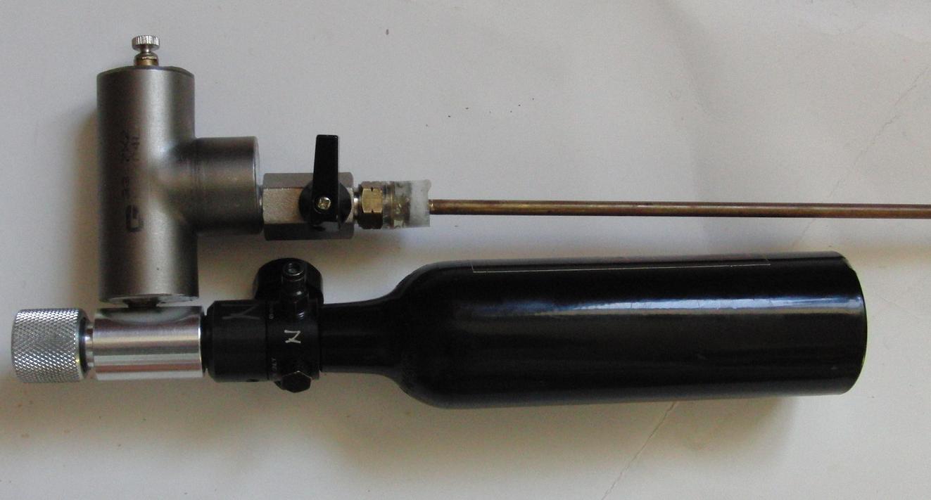

Here's the mockup of the prototype in the meantime:

The tee is baking in the oven together with the sentry gun chamber, medium pressure testing later today if I manage to get home at a reasonable hour.

unfortunately the porting is too big and allowed the BBs to clog up in the ball valve same way the sentry gun did.
My first attempt at this had around 5mm porting through the valve so this was not an issue.
I still want my "overkill" HPA BBMG though, I can either build up the insides, use a 1/8" valve or again go for a "conventional" setup, at 45° with the 1/4" valve there's about double the flow of a 4.5mm barrel and doubtless better than I was getting from my pressure washer handle so this might be the best option.
