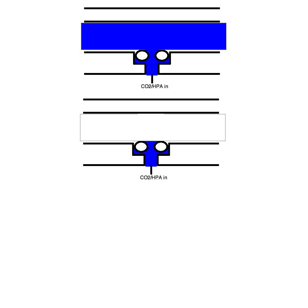

bobgengeskahn
Posts: 84
Joined: Thu Jul 23, 2009 5:40 am
Could something like this work???...
Granted that the shape of a hole drilled into a curved surface is an ellipse, but an ellipse is still just a circle, so an O-ring in something like this, with a relatively tight fitting cylinder should make the O-ring keep its shape and thus keep a seal after it has rotated...
Rotating valve.png (33.09 KiB) Viewed 3324 times

I'm afraid not look at it from a different angle, see how the profile of the oring is flat but the profile of the rod is round, it results in uneven compression and orings don't compress much you need a curved base in the groove to match the curved surface of the rod
you'd have to find a way to make it stay there

what if you were to take a metal cylinder body, drill and tap it for a fitting; then take a sleeve for the inside that has already been drilled slightly larger for the O-Ring. You could make the spacer out of a plastic like delrin, that would allow a tight fit for the bolt assembly while being lubricated...
I would do a drawing for it, but im trying to use paint on a track pad and its a little challenging at the moment... ill try to draw a sketch and scan it in when i get a chance.
edit: Also, after my last post before i got distracted... i was trying to find a resource for square O-Rings... if they exist; or trying to find some other kind of sealing method that would work better... i just like this rotating bolt design too much to see it not done lol

bob I believe I understand what your saying and it should work if you grind the curve in the end of the pipe right and secure the pipe at perfect depth, also square orings don't exist and wouldn't replace your need for a curved surface it would just mean you'd need a square groove, the only thing that would get rid of the curve is a ball to replace the rod and that would be really hard to align, btw you can use sheet rubber to seal things too
