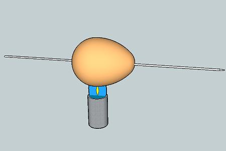

I agree with D_Hall and thought: With the limited amount of fuel you are given then why waste energy trying to boil the water.D_Hall wrote: Hmmm.... I wonder what would happen if you skipped the water and just put the egg over the flame?
By carefully poking a hole (with a needle) in the bottom of the egg, you could run a BBQ skewer through it. After you get it through, carefully poke another hole in the top and then push the skewer the rest of the way through.
If there's egg yolk/white oozing out of the egg, cook this area over the open flame first, to seal the egg to the skewer. Googled this info by looking up <a href="http://www.ehow.com/how_2324833_cook-eg ... ">"cooking egg over open flame"</a>
- cook egg.JPG (7.11 KiB) Viewed 3222 times

however a rotary style of cooking has it's own heat inefficiencies, while you cook one side the other side gets a chance to cools
an optimum design should heat as much of the egg at the same time as possible while minimizing the heat wasted on heating the surrounding medium
