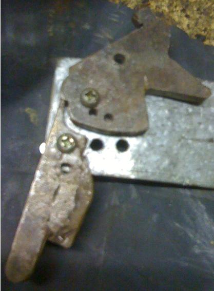

- i have no spring for it yet but i think that ill use a rat trap as boyntonstu suggested to use on a ball valve
- 1.jpg (28.55 KiB) Viewed 5601 times
- 2.jpg (19.5 KiB) Viewed 5601 times
- POLAND_SPUD
- Posts: 5402
wow that looks good... is it from a real firearm/air gun ?

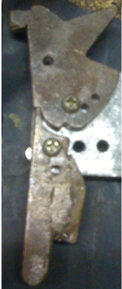

nar i made it today i copyed it from the insides of a cap gun the toy gun was plastic and not heavy or strong enough to use

Nice hammer you've got there.
Effectively the same as on my B2TB breakbarrel gun.
When you get the rat-trap-spring, the coil goes over the axle of the hammer, one end should hook into the hammer, the other should be locked by the main body.

@ -_- Very nice trigger man !! i've just started the same thing as you , bought a cap gun and copy the internals
(only got the hammer done so far
It should work perfectly hoping you can find the right spring !!
Keep us informed and good luck

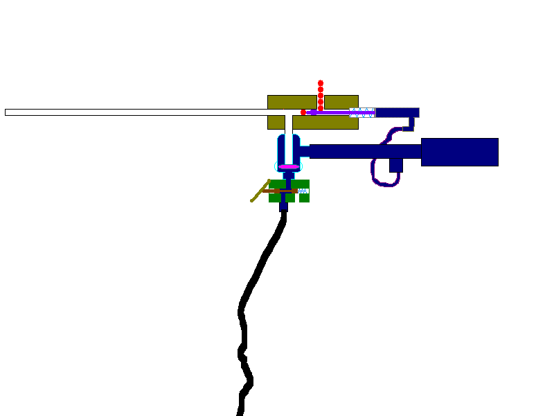

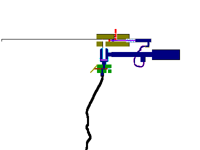

BTB's shattehand uses a modified QEV as the main valve and a hammer valve for piloting... the modified QEV will stay open as long as its pilot valve is open...
However, since the hammer valve opens for a brief moment and vents some air from the pilot side, the QEV also opens just for a brief moment...
as a result you get something that is essentially a single shot...
So it can be said that consistency of the gun depends entirely on consistency of the hammer valve (i.e. how much air it vents each time). If you used just a blowgun the QEV will stay open as long as you keep it open 9so you would waste a lot of air)
so if you want to use something else than a hammer valve with a modded QEV you need to find a way to vent exactly the same volume each time.. A small chamebr for vented air can do that

If you want semi auto just use the set up I have on the PITBULL 9 using a 1/4" QEV and 1/8" Normally open poppet Valve( Clippard MJV0-3) BUT use a different feeding method! as mine can only run at about 110 psi before it double feeds

the 3way releases all the air that you need constant air, just like a nailgun
- POLAND_SPUD
- Posts: 5402
that's why I tried to make sure everyone understands that I was talking about a possible modification of BTB's design...
the PITBULL 9 uses a simple QEV + 3 way valve combo...
when the trigger is released the QEV is filled (hence normally open valve) but when you press the trigger the pilot volume of the QEV is vented to the atmosphere
the semiauto MKIII is exactly the same but it also has an air cylinder that loads ammo (while django's gun uses a simple T to do that)
have a look at the animation you said couldn't open -> http://www.wisc-online.com/objects/View ... ID=HYP4807
or look at the animation I created... I can't believe it took me only 20 minutes to make it
