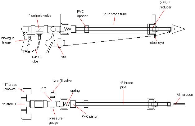

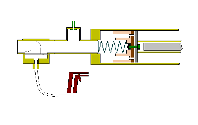

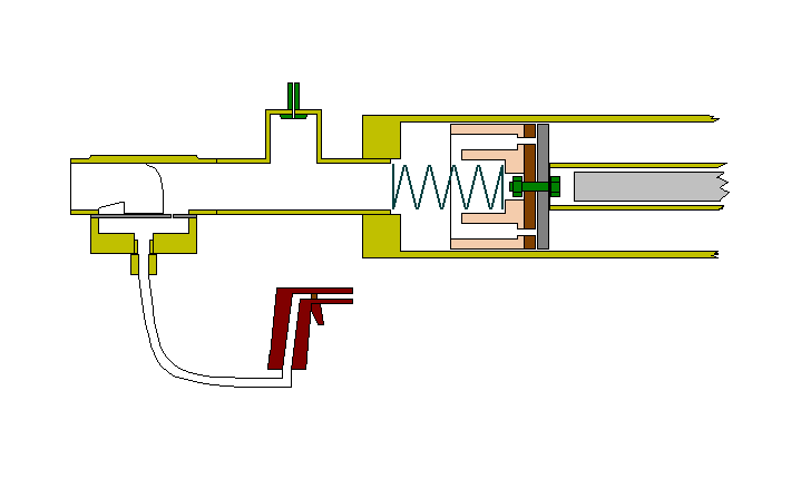

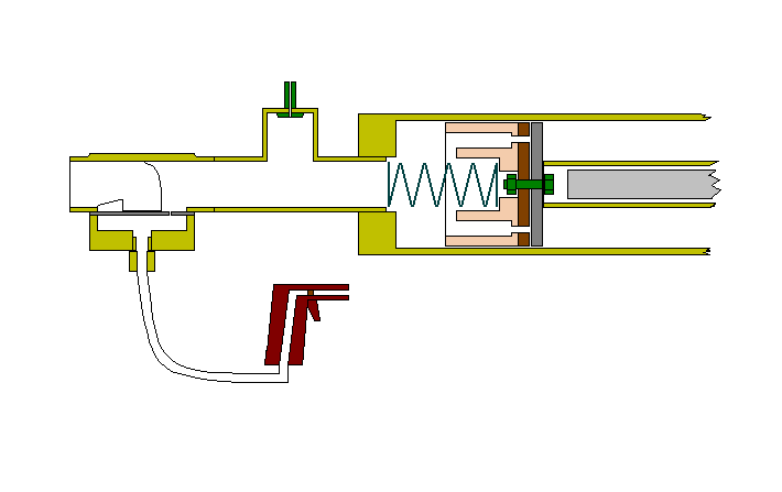

btw, look what I dug up :)
pneumatic harpoon launcher 2 view.jpeg (29.04 KiB) Viewed 5597 times
pneumatic harpoon launcher piston.jpeg (20.02 KiB) Viewed 5597 times

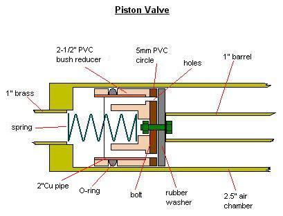

ONEWING
Posts: 47
Joined: Sun Mar 07, 2010 2:11 pm
Ahhh thanks Jack they are the ones. I don't remember drawing that first one but I no doubt did, didn't think I put an O-ring in the piston maybe I drew that as an ideal picture rather then what I did but then how did I know 2" Cu fit into the bush reducer... I'll have to screw it open to find out whats inside there. But then the looser tolerances may be the reason it still works full of mud and spiderwebs.

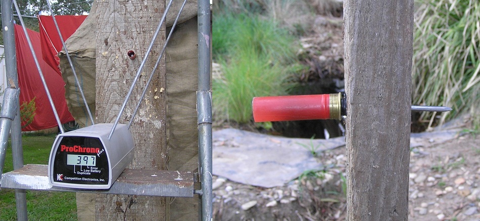

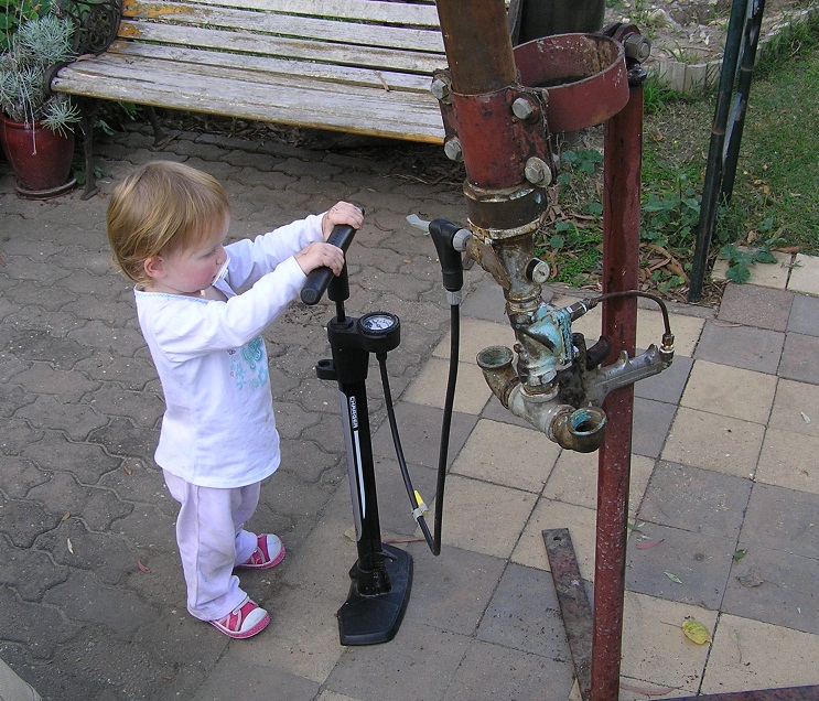

I have some primed cases here so I shot one around until it went off, average fps is in the 290's @ 20psi with an unmodded case and just over 600fps @ 100psi.
Knocking the primer out and replacing it with a nail gave around 400fps at 100psi, chrony result is below.
Thats my niece below, she attempts to pump it up then runs around and cries when she cant pull the trigger.
Started something!
Started something!
Shotshell + nail at 100psi

ONEWING wrote:Thats my niece below, she attempts to pump it up then runs around and crys when she cant pull the trigger.
girls eh :roll:

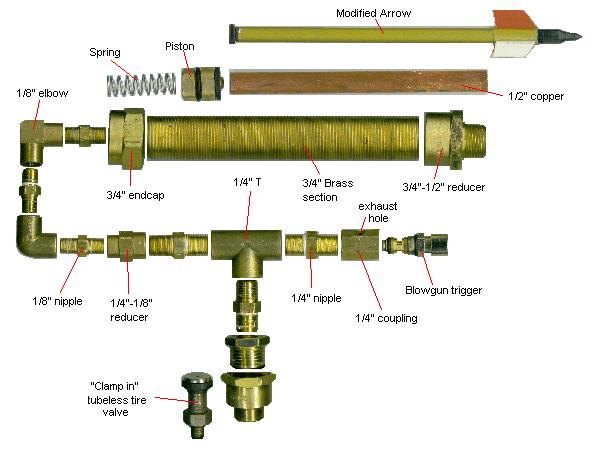

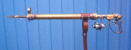

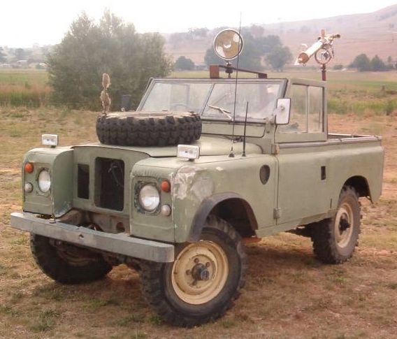

Found a couple more pics on an old hard drive. And another little arrow firing piston gun, the flights slide to the back when fired, it was crap.
exploded parts
exploded parts

On landrover 2
On landrover 2
Harpoon gun side
Harpoon gun side

Wow that brass arrow pistol looks deadly man!
Good job building these, they looked in really good shape back then, why not sand them a bit and polish them up to recover that awesome shine? :P
Edit, Love the JEEEP :D :D
ONEWING wrote:And another little arrow firing piston gun, the flights slide to the back when fired, it was crap.
lol I have those saved too! good stuff :)
Love the JEEEP
