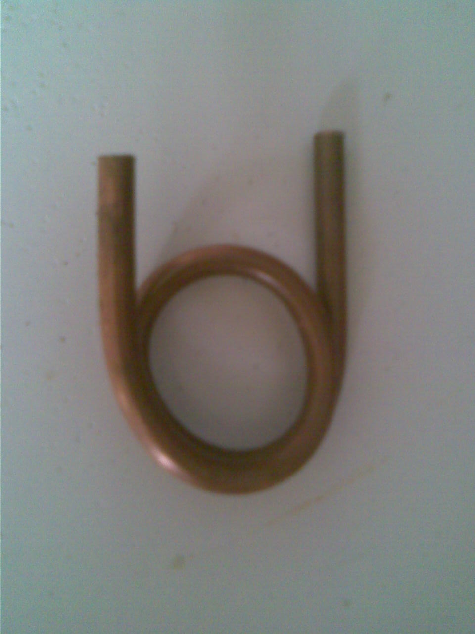

In my experience, low flow is ideal for semi-auto or low rate of fire but if your feed system relies on the BBs being agitated, this leads to feeding problems. Perhaps the solution is to have a tube magazine likethis one. I've proposed the idea before but never did any serious work on it, if I could reliably coil the 4.5mm copper tubing I use as a BB barrel it might just be workable.

I definitely want to see if i can coil the copper tube I have without distorting it...

I tried my hand at bending some copper tubing myself, filled it with BBs to keep it from kinking... using the same steel BBs that you intend to use as ammo isn't the best idea, pretty much jammed up :roll: maybe some 6mm I/D tubing will make a better magazine for 4.4mm BBs...
inonickname
Posts: 2606
Sand will most likely work better than BB's.
