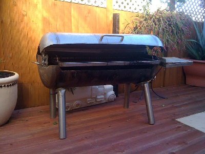

the one i always see is stainless steel so it cant rust.
its like this one but my dad made it into a bbq on the back it has burst @ 6.5 mpa thats about 1000psi
