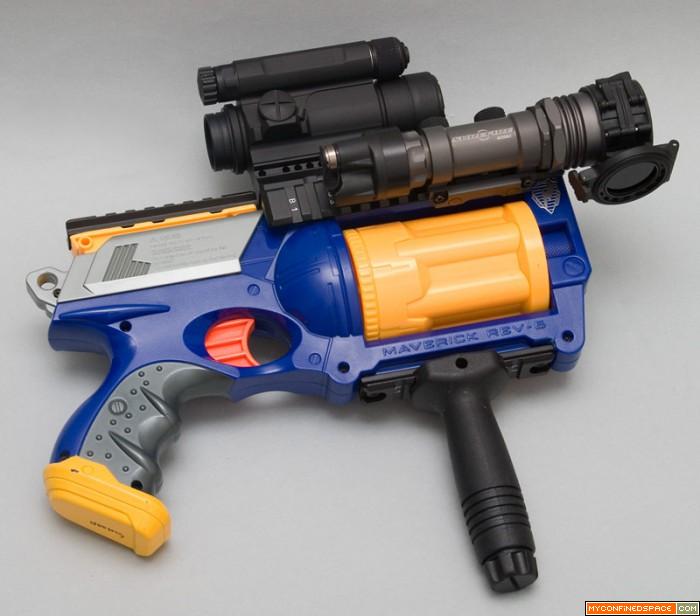

Looking good, not quite "tacticool" but I suppose nerf is nerf. Why not with a Lahti style spring loaded magazine?

Yeah, tacticool was the original plan until I realized running around town with something realistic looking wasn't a good idea. Hence the duct tape.
