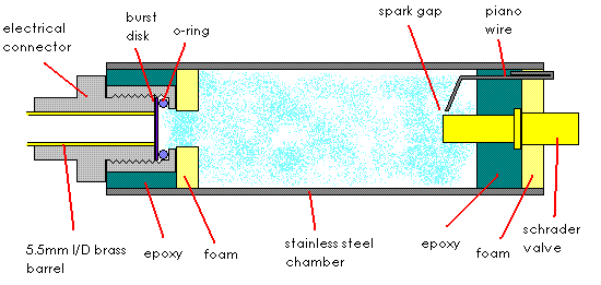

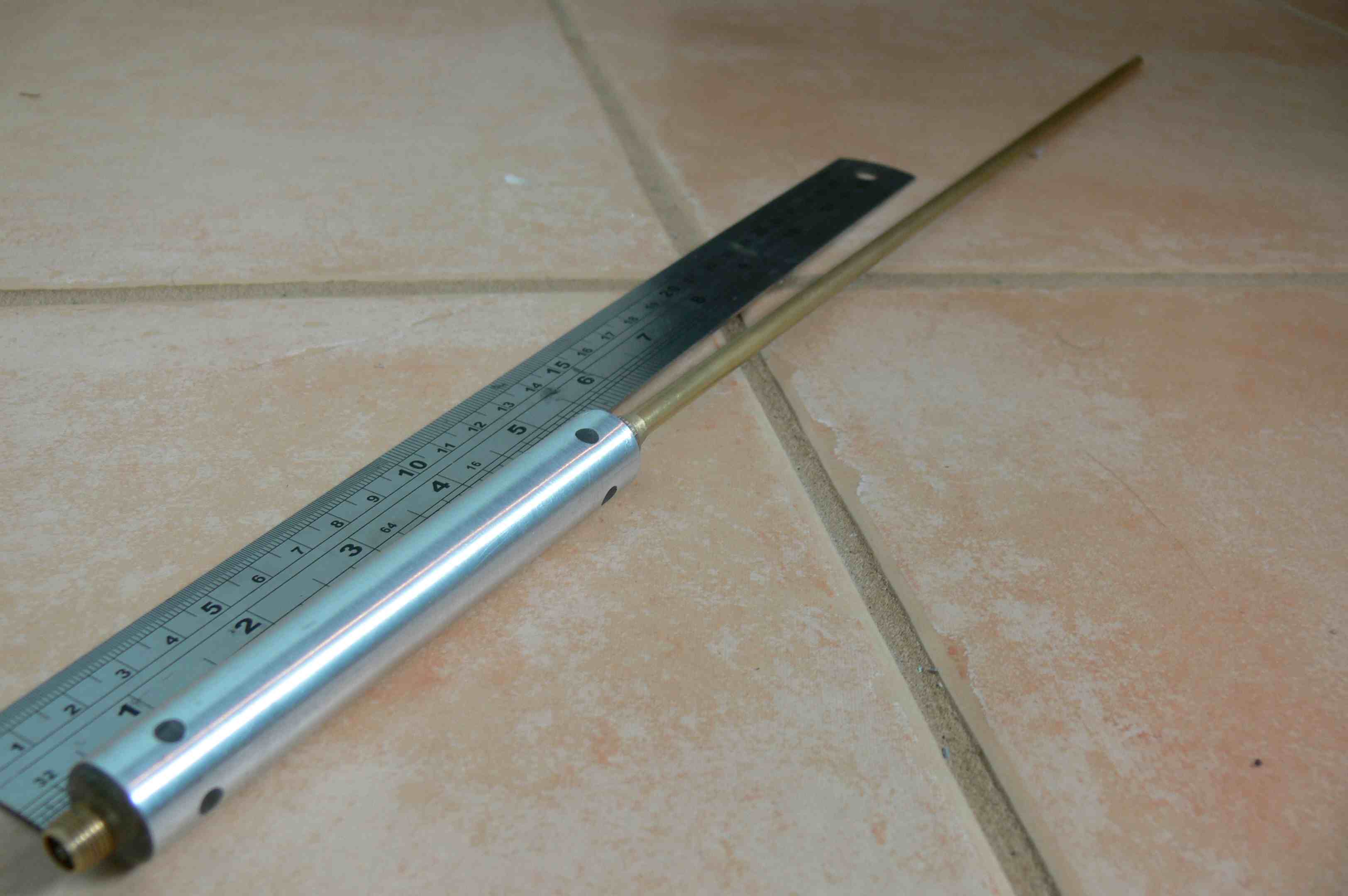

Very cool JSR, congrats on getting it working! are you worried about that plastic electrical connector failing or cracking though?

JDP12 wrote:are you worried about that plastic electrical connector failing or cracking though?
It took a 6x mix without the disk bursting several times and doesn't look any worse for wear, I think it can take the strain. I've used similar connectors in HPA applications (such as my rattlesnake V3) and never had a failure of the threaded section.

In that regard, I might be able to bend the electrode a little further towards the schrader in order to reduce the spark cap and get better ignition at higher mixes.

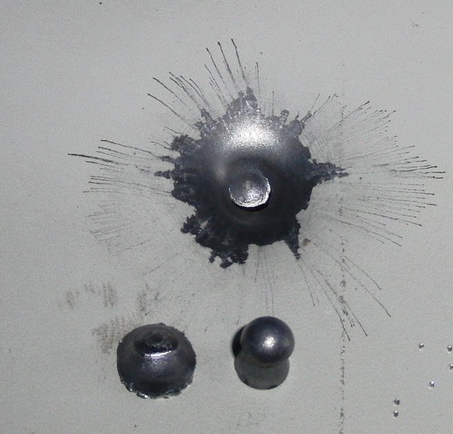

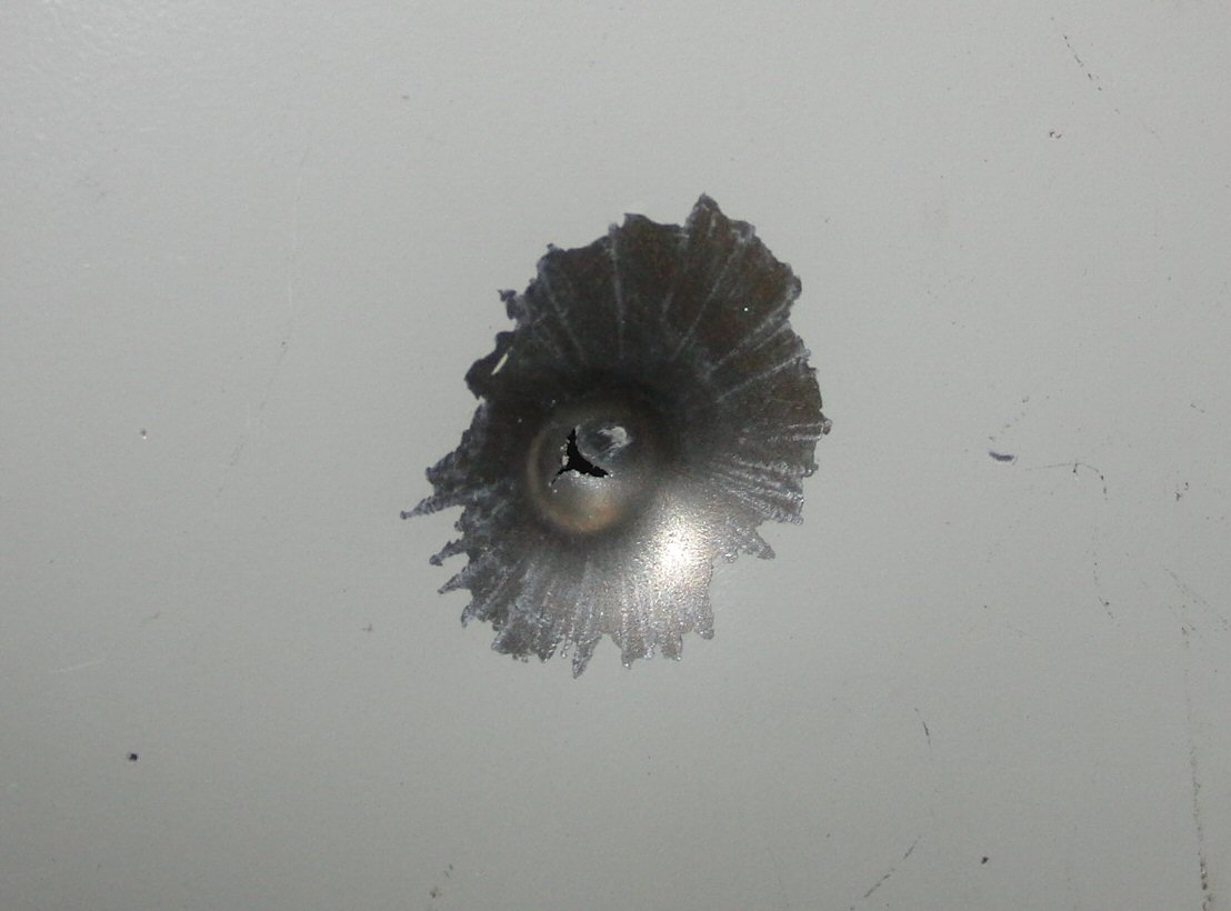

A but of judicious hammering later, managed to shorten the spark gap, it's now happily igniting at 8x, with that a 0.22 almost made it through the 0.6mm steel plate :)

Firing at a soup tin at 8x filmed at 420fps, now do you understand why I don't hold it ;)
0.6mm steel target shot at 8x filmed at 420 fps, just barely didn't penetrate:

edit! woohoo! first click piezo ignition at 9x (6.3mL butane/propane, chamber pressure 135 psi) and it's probably only a few fps from penetrating the steel. Lovely splash from the lead fragments though, I also put in the "before" and "after" 0.22 pellets. With a steel projectile I have no doubt it would have penetrated.
