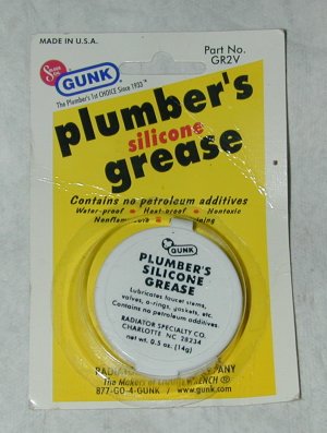

Do you have a Lowes near you ?
For the grease, go back to the plumbing department, which you should know by heart, by now... And look for some plumbers silicone grease.
This is by far, the cheapest silicone grease I have ever found.

I was going to go back and edit, and add pics of the roll pins and the grease. But since you replied, I'll post them here.
Silicone grease
Silicone grease
silicone grease.jpg (27.09 KiB) Viewed 5218 times
