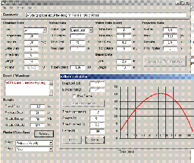

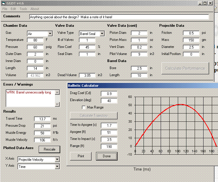

Guys, this is a freaking sandwich launcher! He doesn't need a 4" chamber. If you want a fast 2" valve, using a huge chamber will be LOUD even at low pressures. I don't think your audience will apreciate having to wear ear protection. A 2" chamber is fine, and can always be made bigger by throwing on a coupling and another section of pipe.
So, maybe $30-40 for a large 2"?
Edit: look at the extremely wimpy gun I made in ggdt! Even it can get close to 200ft

A small valve can also limit the initial spike. When I tried simulating a 2", it did increase the performance, though at a cost of over 100 extra gees.
Really, I don't see how you're going to get this thing below 400 or so gees and still get 200ft range.
You can do it with maybe 30 psi, but at that point metal would be completely unnecessary... just use ABS, even of the dwv variety(with a pop-off).
