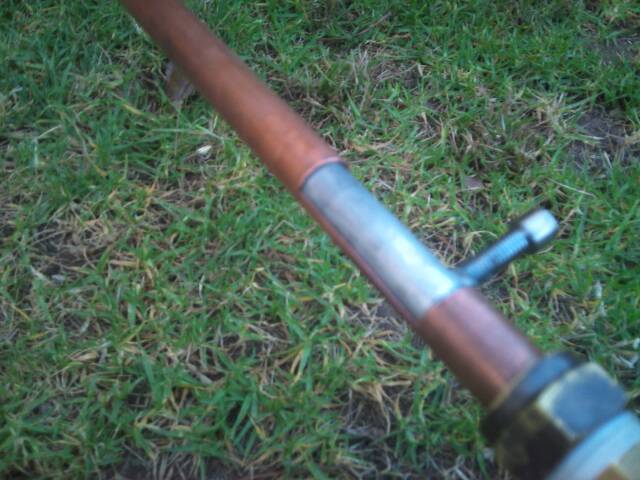

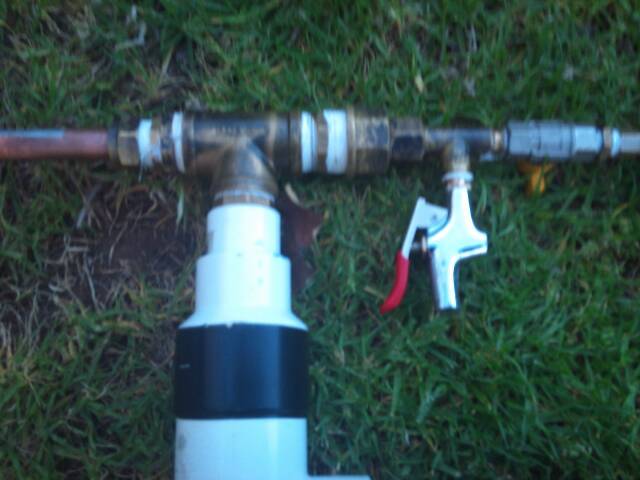

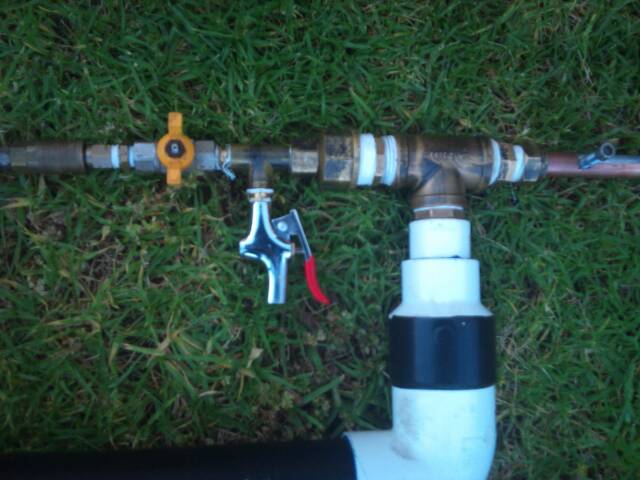

pictures of my gun ill try and get some of my piston and stuff.
If your wondering y there is a blow gun there it is because it did shoot with the blow gun but ever since i have changed the sealing face on my piston it just doesn't want to work, all the air just escapes out of the blow gun
You either have too much friction with your piston, or too much air can escape past the piston from the chamber into the pilot area.
