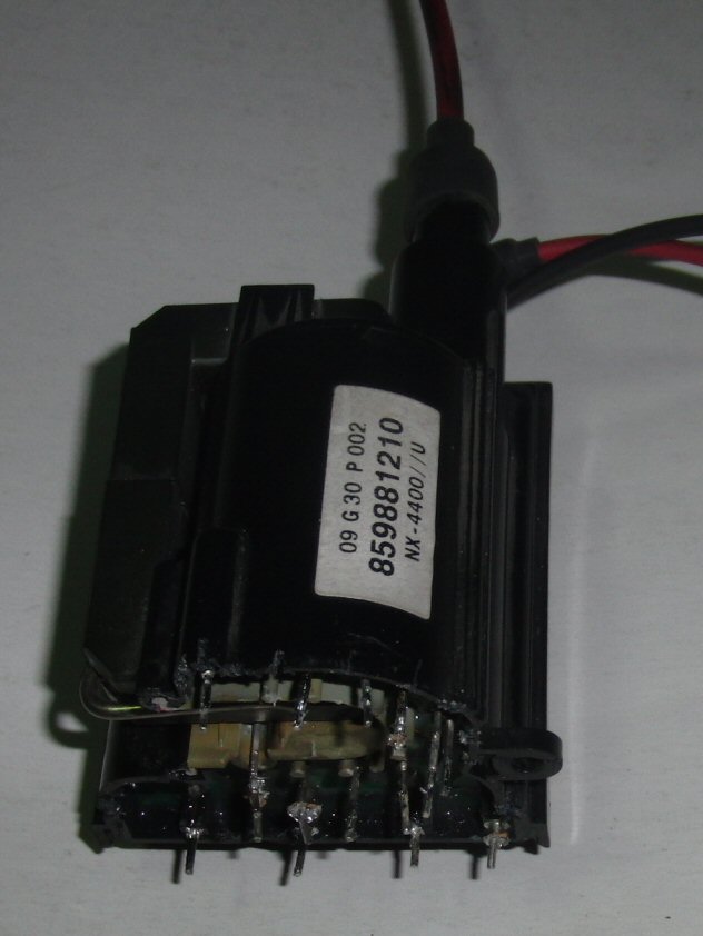

So, after a bit of work with a hacksaw, pair of pliers and a soldering iron
finally got one of the flybacks off.
What's the easiest way to hook them up, possibly with parts I can find on the CRT circuit board itself? The articles I've skimmed through so far are a little confusing.

If there's tiny transformers on your CRT circuit board, say about the size of a fingernail... they are not suitable at all.jackssmirkingrevenge wrote:What about the smaller ones?Hotwired wrote:Yes the flyback is. Does a good few tens of thousand volts in normal use.
Oh I did that, worked fine. I did however use my own transistors and not any of the suggested ones. To be honest most transistors will work if they're the right type and not hugely underspec, details such as the best one for it can be sorted once you have a working circuit.motorfixer1 wrote:I was toying with the flyback driven ignition source for a while and I found these two sites in my travels: http://www.angelfire.com/80s/sixmhz/flyback.html

Flyback testing...
The primary coils I found were all on one side. You can check this with a continuity meter or if you don't have one, a battery and a bulb can also check for continuity.
There's more than one coil on the transformer you see, and terminals which are linked together are on the same coil.
You can see the Yellow leads which I had on one winding as the primary winding and the Green leads on another winding for feedback. There's a bit of fiddling about needed to find the best sets of terminals to use for each.
The black lead was on the terminal the HV wire (thickest wire coming off the top) most liked to arc to. There's several it will arc to easily but there's a favourite.
But frankly, those circuits are HIGHLY inefficient for ignition. You can see several references to the transistor roasting itself in there and requiring a massive heatsink.
It's drinking current that's why. You do get a sizzling high frequency spark of course but you have to pay in size, heat and power consumption.
If that's what you want then knock yourself out. But there are more efficient ways to drive the high voltage coil for ignition.

So, take out transistors and resistors from the CRT board (I think they are transistors, vague recollections of my physics teacher referring to "three legged beasts"Hotwired wrote:To be honest most transistors will work if they're the right type and not hugely underspec, details such as the best one for it can be sorted once you have a working circuit.
I bought a lucky dip bag of transistors and almost all worked, to various degrees.
I actually have a continuity meter, is this what I need to do?The primary coils I found were all on one side. You can check this with a continuity meter or if you don't have one, a battery and a bulb can also check for continuity.
I just want a big enough spark to evaluate the power potential of a 28x mix for static testing, not too concerned about efficiency and bulk at this point. Also, I have heatsinks. And fansBut frankly, those circuits are HIGHLY inefficient for ignition. You can see several references to the transistor roasting itself in there and requiring a massive heatsink.

No harm in it at any rate except to patience if they don't work. Tricky bit with transistors you don't know is which legs are which and if they're npn or pnp types. They have codes on them you can look up though.jackssmirkingrevenge wrote:So, take out transistors and resistors from the CRT board (I think they are transistors, vague recollections of my physics teacher referring to "three legged beasts") and have a play
Yes, that's a more organised way of going about it, I just checked which terminals linked up personally and then applied voltage until the HV line gave off the best arc.jackssmirkingrevenge wrote:I actually have a continuity meter, is this what I need to do?

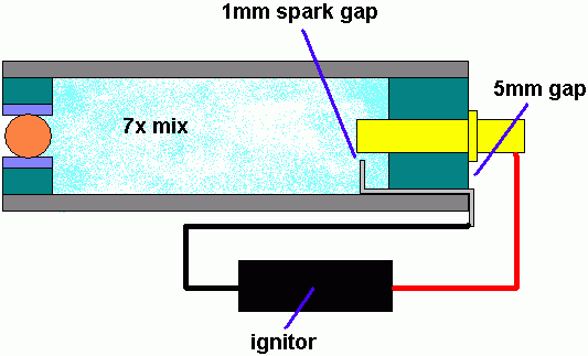

As to a more permanent solution, this from LaunchPotatoes.com is what Lockednloaded was referring to, right? I would think the USG offering is pretty much the same thing?
Another question - which may or may not make sense - in the case below, would the spark still prefer to arc across the external gap between the schrader and electrode, even if I was feeding it higher energy than a piezo?
- gap.gif (9.8 KiB) Viewed 3577 times
you might be able to get away with a few more times mix but i have still had problems with my high energy igniter externally arcingjackssmirkingrevenge wrote: Another question - which may or may not make sense - in the case below, would the spark still prefer to arc across the external gap between the schrader and electrode, even if I was feeding it higher energy than a piezo?

I imagine this will be true of any high voltage ignitor, hmmm... this complicates the issue somewhat given my love for epoxy encased unservicable launchers...Insomniac wrote:the very powerful, high-current arc will tend to melt away the electrodes a bit, so you'll have to keep readjusting them. Not ideal for a cartridge.
No. It's only true if you're also delivering a very high current as well. Well, all arcs are going to wear away at the electrodes to some degree, but, for example, something like a grill ignitor can sit sparking away for a very long time before any significant amount of the electrode wears away... notice that when you spark a piezo, you only see the blue arc, and no bright orange metal sparks? Contrast this with what happens when you allow a camera capacitor to discharge:
See the difference?
See the difference?
