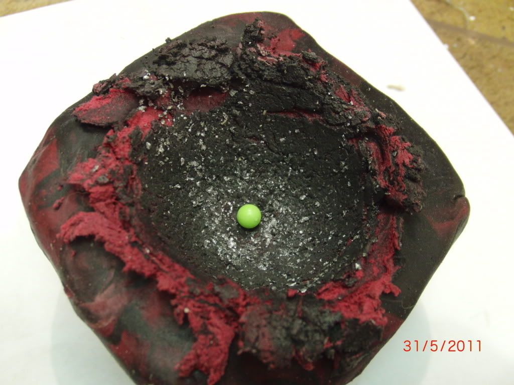

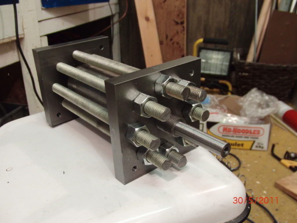

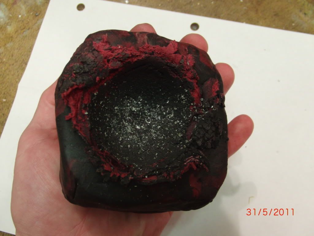

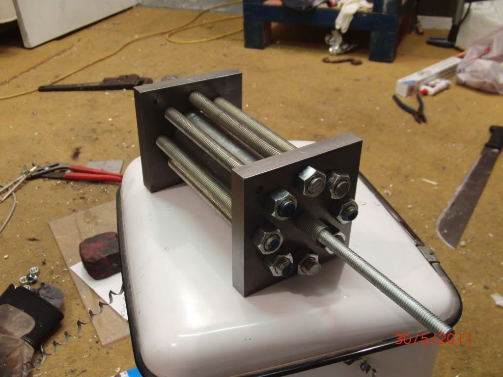

Below are a few pictures of the test device and impact result (the round in the crater is for comparison, as the only remains found of the one launched during the test was a single fragment of less than a cubic millimetre).
Internals of the test device:
Front view:
Rear view (that's an electrode sticking out the back):
Impact area comparison photo:
