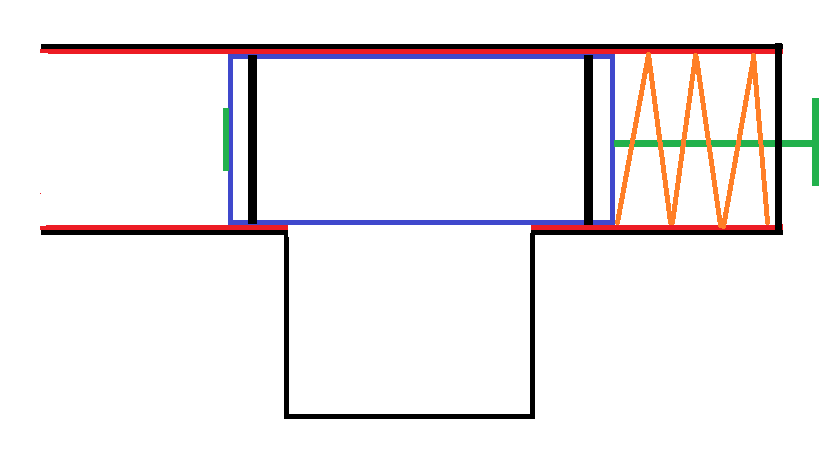

Since I only have one port will this cause the piston to be hard to pull?

One port, meaning one hole cut in your cylinder? If so, negligibly.
The number of ports doesn't make a difference. The pull force is when the rings are sealed on solid pipe. Once moving, and the port opens, the air will assist the opening and it will finish opening much faster than you can possibly pull it.

I'm using PVC, so no sanding. I have little patience on thing like that, but I was afraid all the upward pressure from the port at the bottom will make it hard to trigger but I guess not, thanks, the piston is from standard pve fittings.

clemsonguy1125 wrote:I was afraid all the upward pressure from the port at the bottom will make it hard to trigger but I guess not
No because air is also going to get of the other side of the piston, making it a ballanced force.

But it would be the force required to start the piston moving. But it shouldnt be an issue.

No it won't :D Air pressure is pushing equally all around the piston. The only resistance to opening is the o-ring compression against the wall of the cylinder.

Thats good, but the only open part will be at the bottom of the tee where the port is. I need to make a sketch later.

I understand that, but no matter where the opening is, as long as air gets around your piston, it will still be ballanced, as I said before.

That what I was missing, air leaking around the piston thanks.
