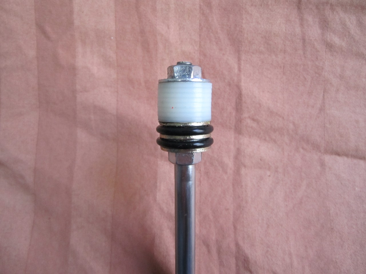

Thanks for the tip on using teflon tape to size up a washer- I dunno why I never thought of that before. Do you glue it in place at all or no?

My piston is for my 2" piston valve. It is extremely heavy though
I guess it makes sense, how you have all that stuff on it. But I seal the front washers, where it leaks through to the seat, with JB Weld. It is less bulky. Thats what I though you used the rubber for though.

Nope. It's not great for large size differences but it works on sloppy o-ring grooves just fine. I just wrap it tightly and it stays.JDP12 wrote:Thanks for the tip on using teflon tape to size up a washer- I dunno why I never thought of that before. Do you glue it in place at all or no?
@jhalek: Does it completely seal off the pipe or no? If so how do you accomplish equalization?
@Gun Freak: I see, it's a just a different piston from the one in the thread. I would have used epoxy to seal the leak but I like being able to take apart the piston when I need to.

Yeah I didn't post that picture in the original post, but it is somewhere in the thread. I know what you mean by making it undoable. I do the same thing sometimes.

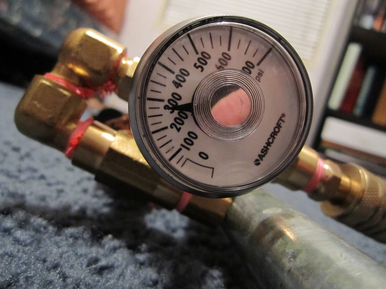

[intercourse] I feel like an idiot now.
Despite the revised pump head, the o-rings are extruding themselves through the clearance gap at pressures above ~220 PSI.
My piston is 3/4" diameter, and type L copper tubing (3/4") is .785" inside diameter.
However,
Working on the pump, I noticed I had somehow bought a piece of type M copper tubing for the pump body, giving a clearance gap of 0.0305".
So, unfortunately, the testing I planned for today is delayed even more until I buy a length of type L and a female adapter to fix this.
Or, I might wait to but a HPA source, since, after cutting down the chamber, I can now get about 14 shots from a fill. Not spectacular, but it's better than 6...
EDIT:
*blares Celebration Day from Zep. III*
Finally got my pump working. As stated, I simply replace the pump body with some 3/4" type L and have no more problems with o-ring extrusion.
However, my piston leaks past ~250 PSI, I've found out.
I'll just have to attack that tomorrow with some dowel rod and stick-on sandpaper I guess. Even with the leak, I just leaned into the pump as hard as a could, but ran out of steam at around 275 PSI (the thing would have been to 450 by then without the leak).
Overall, the HP side of this project is coming along nicely.
However,
EDIT:
- POLAND_SPUD
- Posts: 5402
I think you should get larger diam. washers. That should solve the problem

I agree on the washers. I can see why you used those though, if you couldn't get the right sized ones.
