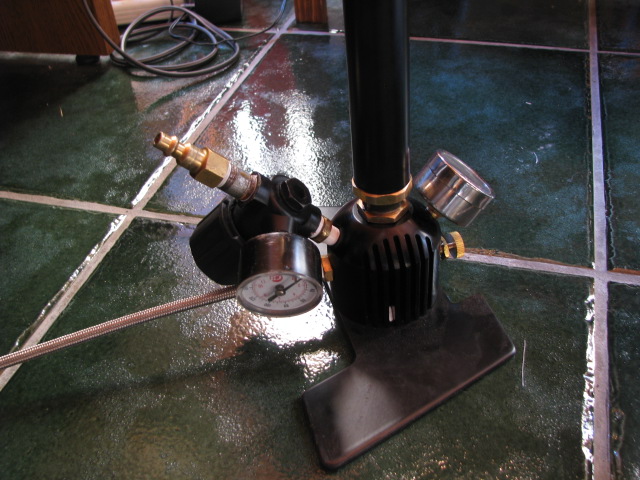

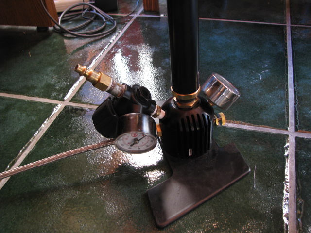

Hey guys, I went ahead with the mod and attached a regulator and quick connect to hook up my air compressor to the input on the pump.
Check out these facts:
before the mod it took me 13 min. and 300 pumps to fill a 20oz. c02 tank to 1000psi.
After the mod it only took me 100 pumps and 3min. to fill the said tank to said pressure. I adjusted the reg to 25 psi input to the pump.
I also noticed that the pump head stays cooler.
