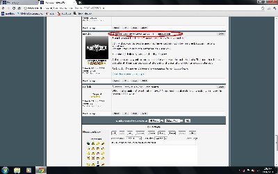

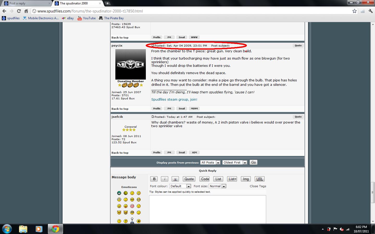

Crna Legija
Posts: 2333
Location: australia
RJB INDUSTRIES wrote:If you want the plans to do a H2 Reactor i can help you...
if you wanna stop kicking up dead topics, i can help you.
wyz2285
Austria
Posts: 2388
Location: Porto, Portugal
well, at least not a really old one, 4 month :roll:
