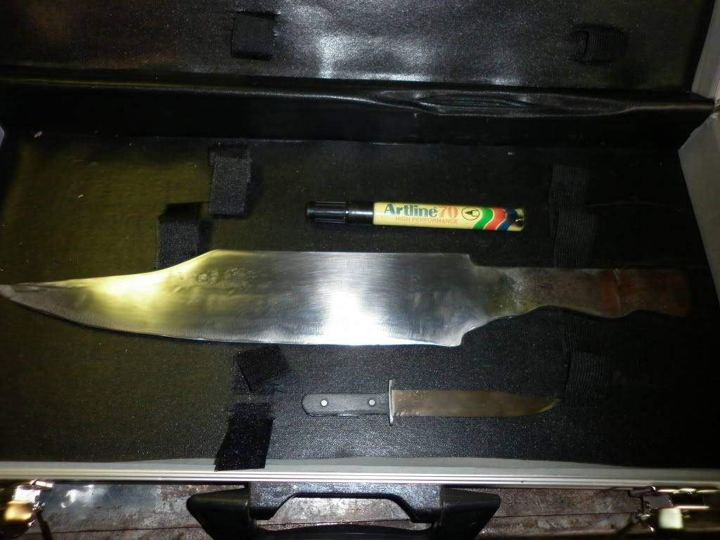

I've done a few knives. A leaf spring is a decent source of really hard metal. You'll need to heat it, forge it flat and then make your knife, then retemper, but it'll be very strong.
Here's a little Bowie I did from a leaf spring:
