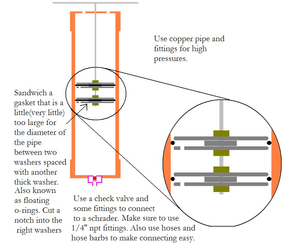

The pump design is something like this. I don't have any CAD programs so Paint will have to do. I suggest using thick(1/4''?) o-rings to optimize the seal and minimize the chance of o-ring failure. Most hardware stores sell 1/4'' NPT hoses with the fitting already attached. It may be tough, but find a thread-on Schrader coupling for 1/4''.
