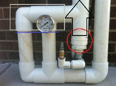

Alright. Well, my piston blew out the back of my gun. I didn't have time to get pictures yet, but I am showing you guys basically what happened on an old picture. The red circle around the female adapter is where the damage happened. Basically, it blasted off the threaded part and left the solvent welded part attached to the rest. I think I'm just going to replace the whole piston housing with a schedule 80 version of itself, from the black arrow on up (also including the back female adapter), and the part in the white box with schedule 40 parts. Also, the blue line is where I cut the pipe, just going to add two couplings.

Also, I feel like this is a stupid question, but schedule 80 parts will solvent weld to schedule 40 parts correct? The black is just for color coding?

Schedule indicates a wall thickness, and usually corresponds to a different ID only, same OD based on pipe size.

And MrCrowley, yeah I think that with a more suitable bumper and a schedule 80 housing I should be alright, and I'm not totally understanding what you mean about making the PVC "concave".
Also, do you guys think it's okay to have the part in the white box be schedule 40 or should i go right ahead and make it 80?

Oh and also one thing I forgot to mention in the above post, since I know that my piston fits well in 2" schedule 40 pipe, do you guys think it would be okay to put schedule 40 in schedule 80 fittings, assuming I have a decent bumper?
