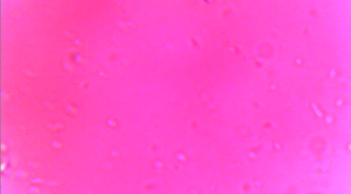

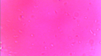

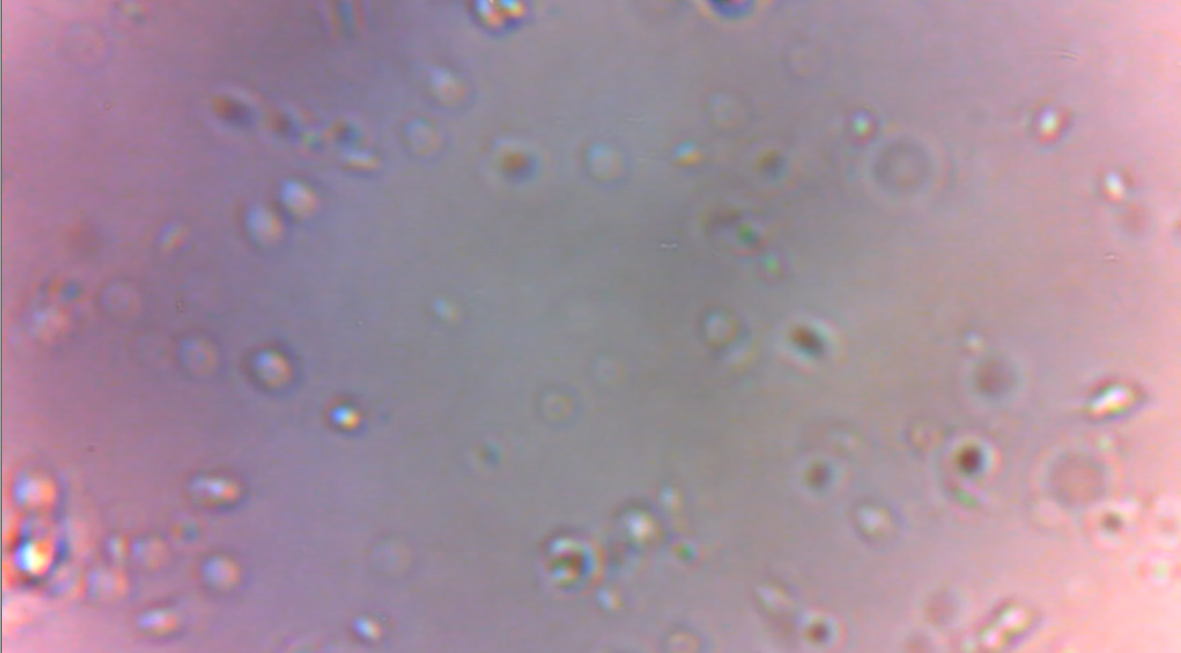

I've finished the mod for LEDs which works great but I'm getting a weird pink hue on the sides of images when using the HD webcam missing the IR filter.
I removed a bunch of filters from a SharpVision slide projector. I got what appear to be 2 polarizing filters and 3 unknown filters. I'm hoping one of them is the IR cut filter.

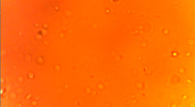

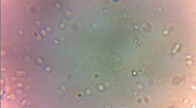

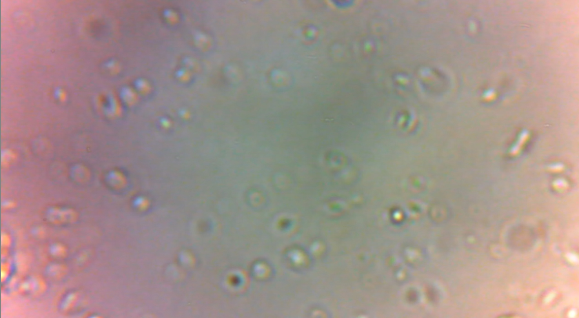

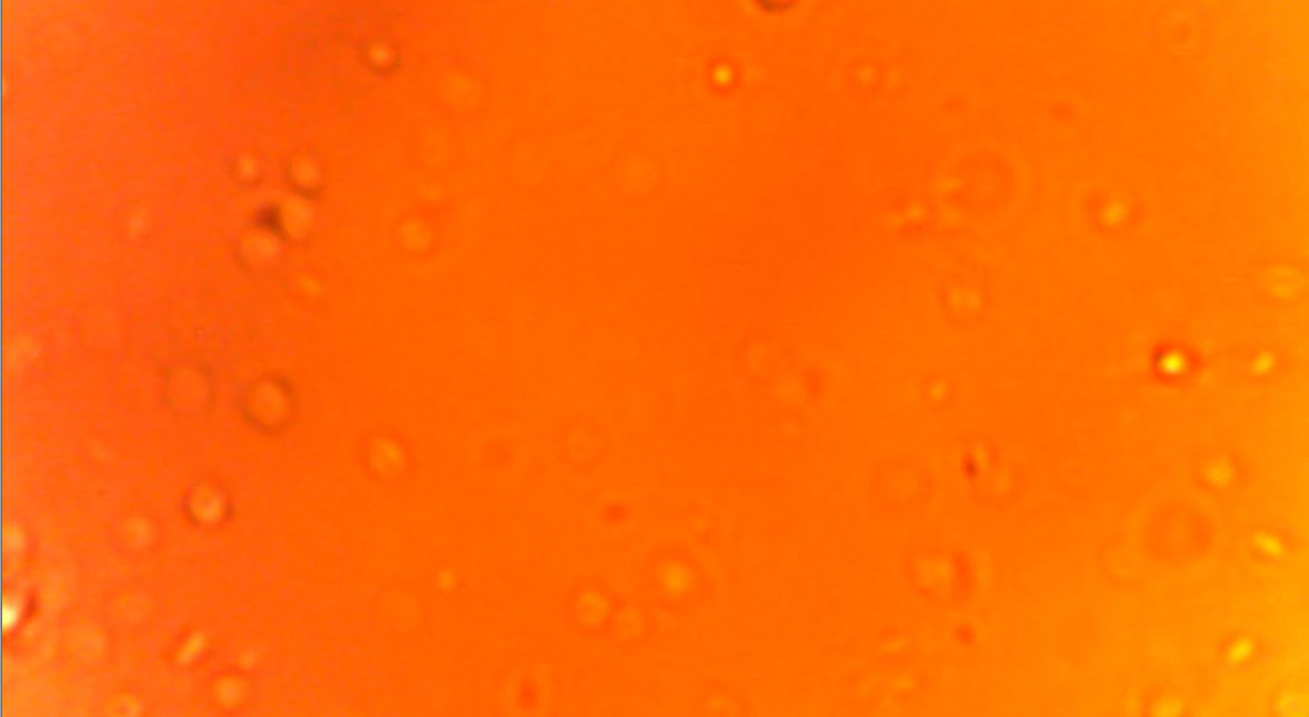

The photo "normal" shows what I see on my computer when using the webcam. Normal colour in the middle with pink colour on the sides. The three photos titled "filter 1", "filter 2" and "filter 3" and the three filters from the SharpVision. Two of them don't seem anything like IR filters and one of them has little effect. I'm beginning to think that maybe this pink hue on the images isn't actually IR but there is a problem somewhere else.
The three filters were found stacked in a row at a 45 degree angle to the light source. After that came a polarising filter, some mirror like thing connected to the circuit board which must project the image and then a second polarising filter before the lens.

A camera IR filter often has a bluish tint to it in the visible spectrum. Removing it without changing the color balance on the camera will produce orangish photos such as your filter2 photo. On a single pickup CCD, (without a beamsplitter and 3 pickups, IR tends to show up as a green color in the photo much like the Sony Night Vision mode with white or IR.
Weird colors in the other photos can be a result of polarization artifacts as many cameras have an internal filter.

Are you talking about an IR cut-off filter (heat-absorbing filters) or one that allows IR but blocks visible light (cold filter)?A camera IR filter often has a bluish tint to it in the visible spectrum. Removing it without changing the color balance on the camera will produce orangish photos such as your filter2 photo
I'm just a little confused about your wording because I'm not removing a filter from the webcam to achieve the orange photo, I'm holding a filter in front of it. Changing the white balance while holding the orange filter (filter 2) in front of the webcam (which has no lens or IR cut-off filter, just the sensor) only changes the colour from orange to purple to blue to yellow to red to whatever, i.e., I can't get white.
An internal filter built in to the circuitry or on the sensor?Weird colors in the other photos can be a result of polarization artifacts as many cameras have an internal filter.
What items do you suggest I should test to see if they are changing the polarization?The two two polarizing filters can be used to look for items that change the polarization.. This can change the amount of light permitted to pass through two polarizers depending on the material in between. This is how a LCD display functions. With one or both polarizers missing, there is no image.
Sorry if I misunderstood your post, just wasn't sure if we were on the same page.
Edit: Okay, just did a test with the webcam and a TV remote. None of the three filters block IR. Is there a chance the IR filter for the SharpVision slide projecter is inside the lens itself and the three random filters are merely to change the colour of the light from the light source before they are projected on to a slide?

I think your last edit is on the money.
To test if a camera has an internal polarizer, rotate a polarized lens in front of it and see if the lens darkens and lightens as it rotates. If rotation has no effect, the camera is not filtered. Most are not filtered.
The IR filter in a camera is on the sensor, is bluish in color, and is an IR cut filter.

Ah, that is smart. I gave it a go and no change was obvious.To test if a camera has an internal polarizer, rotate a polarized lense in front of it and see if the lens darkens and lightens as it rotates. If rotation has no effect, the camera is not filtered. Most are not filtered.
I thought it was the IR-pass filters that looked blue? I had followed several different articles on modifying the webcam and they all said I would have to replace the IR cut-off filter as it would be removed and it appeared I did remove the one from my webcam as it was glued to the back of the lens mount, it's colour was similar to this. I can't test it to see if it stops IR because I can't remove it from the lens mount without damaging it.The IR filter in a camera is on the sensor, is bluish in color, and is an IR cut filter.
If you are right and the IR cut-off is on the camera sensor, I just need to figure out what is causing that pink hue on the sides of the image.
Thanks for your help so far.
The IR cut filters either appear pale turquoise or ruby red, depending on how they're viewed. Looking through one it will have a blue tint, while light reflected from the filter will be red (as it reflects deep red and IR light to function).

Interesting. With my back to the window (only source of light in the room), holding up one of the filters in front of me shows the reflections as blue and looking through it everything is orange. Does that make it an IR-pass filter?
- Technician1002
- Posts: 5189
Their are several different ways those filters are manufactured which affects their response in the visible spectrum. They are cataloged in two major camps.
Thin layer Dichoric filter. This filter absorbs very little light, but reflects some wavelengths while passing others. These are easily identified by the reflected image is a complimentary color to the pass image. They work by reflection of the unwanted color. The color will have a shift as the angle of the filter is changed. This may be the source of the pink edges in the photo above.
http://en.wikipedia.org/wiki/Dichroic_filter
The less expensive filter is an absorption filter.
This filter is simply colored glass formulated to absorb and block the passage of the unwanted color. This filter does not have a color shift with a change in angle and does not have a strong colored reflection.
The absorbtion filter is more difficult to get a sharp cut off response than the thin layer filter. The thin layer filter is more expensive to manufacture as it is most often built by depositing many layers of 2 or more clear films of different optical densities to create a selective frequency to reflect.
Custom colors can be produced of any wavelength using the thin layer filters. Dye based absorption is limited to the range of chemicals used to dye the glass. Dye based filters can fade. Thin layer filters are noted for their long life and stability.

Well that sounds like that orange filter I have. Unfortunately it's not the source of the pink edges as that photo (normal) is without any filter being used.Thin layer Dichoric filter. This filter absorbs very little light, but reflects some wavelengths while passing others. These are easily identified by the reflected image is a complimentary color to the pass image. They work by reflection of the unwanted color. The color will have a shift as the angle of the filter is changed. This may be the source of the pink edges in the photo above.
I'm wondering now if it might be something to do with the LED collimator or not enough illumination. Although I seem to have more than enough illumination even at the highest magnifications.
