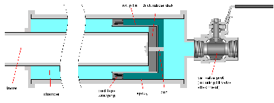

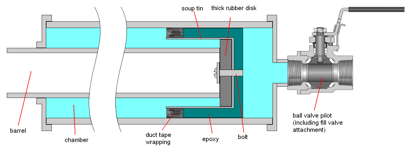

JSR, that tutorial on how to cast a epoxy piston is great. In the pics it looked to be a cup piston, with the piston being a 4 inch diameter should I do a cup piston or the piston that is a plain cylinder? Would epoxy be the best material? Was thinking about having foam in the middle as you mentioned because I'm a little concerned with that large of a piston flying back with 200-300 psi.
For a relatively large piston I would definitely make it cup shaped, to save on material and weight. Here's roughly how I would put it together:Atattack wrote:JSR, that tutorial on how to cast a epoxy piston is great. In the pics it looked to be a cup piston, with the piston being a 4 inch diameter should I do a cup piston or the piston that is a plain cylinder? Would epoxy be the best material? Was thinking about having foam in the middle as you mentioned because I'm a little concerned with that large of a piston flying back with 200-300 psi.
