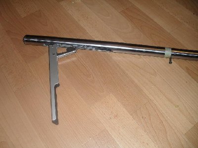

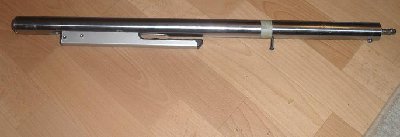

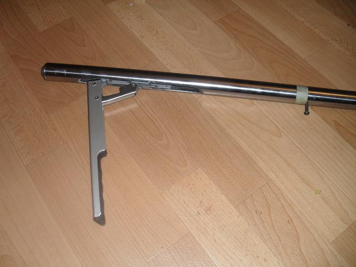

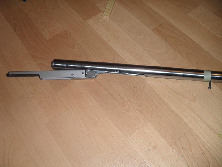

Let's turn this into a build log:
Need to fix a damaged O-ring on the checkvalve ( due to a bur on the hole for the fixating bolt.. :cry: ) I'll fix that tomorrow.

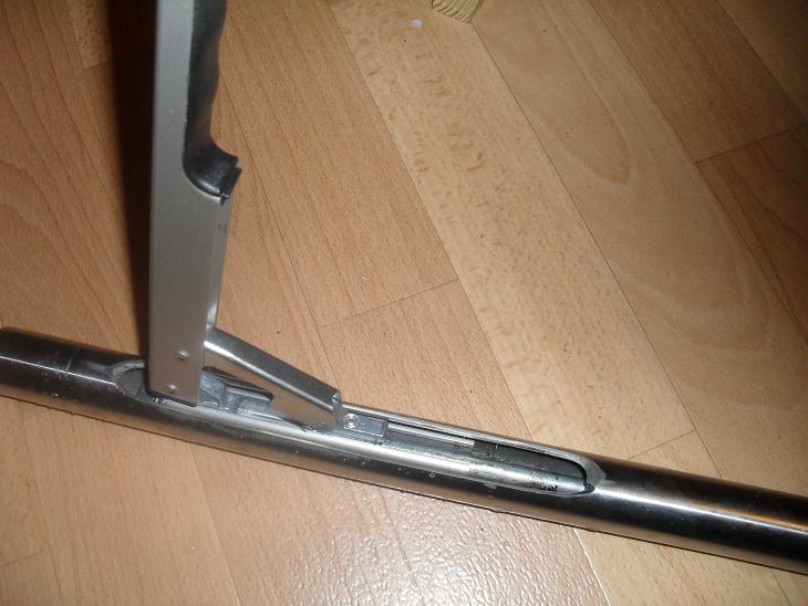

The pump piston is solid brass ( 25mm round bar) with a floating O-ring and airpassage cut into the head.
It connects to the Leverarm via a 9 mm steel rod, one end lathed to fit the mechanism and heat-crimped onto the piston head.
I also need to clean up the cut out on the seamless pipe. :roll:
I have gone with a massively large reservoir ( for this design at least) so the pressure will stay high up to the point where the ammo leaves the muzzle.This will be tuned in by adjusting the hammer spring. :wink:
So...The first time I'll pump it up it will need a LOT of pumps...after that the reservoir will retain some pressure so I won't have to start at 1 Atm.
It's got a leaky O-ring on the outside of the checkvalve due to a burr...I'll fix it tomorrow.It does build up pressure though!

Oh...it's working now. :D
It just needed some cleaning and some oil.Now everything seals and it builds up pressure pretty well!

now if I might provide some constructive criticism...
have you considered putting the pump the other way round... uhmm I guess that isn't clear enouh
I mean that the lever gives you most force when it isn't needed (at the very few cm of stroke) and least when it is most needed (the last few cm of stroke)
Also... what's the point of this type of pump... wouldn't it be better to build a smaller pump (piston OD of let say 6mm) without a lever?
Note that I understand that how these pumps work... my question is wouldn't it be better to do 10-12 strokes instead of let say 3 strokes that require more strenght ?
That pump style is noted for a good mechanical advantage on the last 10% of the stroke. This is why it is popular on air rifles. Air rifles don't come with a straight stroke like a bicycle pump for a good reason. The mechanical advantage permits higher pressure.
Air compresses. Pump resistance is high on just the last part of the stroke.
A water pump works better with a linear motion. Resistance is the same the entire stroke length.
ohh yeah sorry I must have had a brain fart... I own a PCA airgun that has exactly the same pump design
It's exactly the other way round, sorry :D
Still the piston seems rather large.. are you planning to develop a PCA or a PCP with an onboard pump.. mind you I am not asking about this particualr gun but what you are aiming at?
A large diameter means that dead space is smaller in comparison to the length of the stroke.
I tried a 16mm version earlier and that topped out at 20 bar while pumping remained easy
The stroke simply wasn't long enough to compress it any further.
The O-ring groove and checkvalve moevement mean there is a small amount of dead space.This determines the limit of the pressure the pump can reach.
