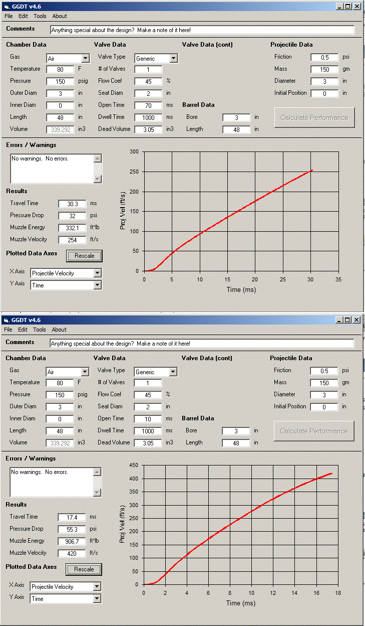

Yeah, your valve has a fairly low-mass diaphragm with a decent "step-up" ratio when it cracks open (meaning, when it opens, the air pressure will suddenly have more sealing face area to push on and thus open faster).
I'd figure it's probably close to 10 ms if the pilot valve works well.
I talked to one of their engineers today and he said it opened between 50-70 ms. I hope it opens in 10 ms.

If he can actually cite lab test results then I'd tend to believe him, but with only GGDT to pull numbers from I can't get this valve to open much slower than 40 ms... still quite a difference and that was calculated with horrible pilot params.

This depends on the parameter being measured. If this is a delay (which I think it is) there is a delay while the pilot and nominal pilot plumbing is vented before the valve unseats, then it pops open.Atattack wrote:.07 seconds? It is a dust collector valve which is supposed to be one of the fastest valves. Double diaphragm port valve. Isn't that pretty fast?
Most piston valves and membrane valves need the pilot to drop to a low pressure, then they pop open. You can see that in the sound recordings of many piston valve cannons. It is hiss-boom..

Model it in GGDT.. When launching eggs, I found they can fly the distance from an industrial park building over a car dealership lot and drop on the roof. A small higher pressure valve would have most likely broken the egg on launch. I wonder if the dealership heard it land on the roof.
