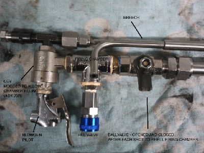

Well what are you waiting for...slap some sights on! But it's a very nice gun. You'll get the accuracy issues ironed out easily, I'm sure. Good work!jmez1996 wrote:inonickname wrote:yeah i know its not great but i can hit a softdrink can at 14m with my first shot with no form of sights so im happy enoughjmez1996 wrote:
Sorry but that's not great accuracy from a vice at 10 meters. It's a result of the smoothbore barrel and projectile.

That's quite a beautiful gun you've made! If you can afford it, you could mod the air tank to fit a PCP pump, and then you'd really be in business.

Would suggest you try swagging the pellet skirts up in diameter to fit the bore well...should have to push them in a little...if they fall right through...accuracy will definitely suffer.
Nice job on the build.
Yeah they are fairly tight in the breech, once the pressure drops too low sometimes they get stuck.Gippeto wrote:Would suggest you try swagging the pellet skirts up in diameter to fit the bore well...should have to push them in a little...if they fall right through...accuracy will definitely suffer.
