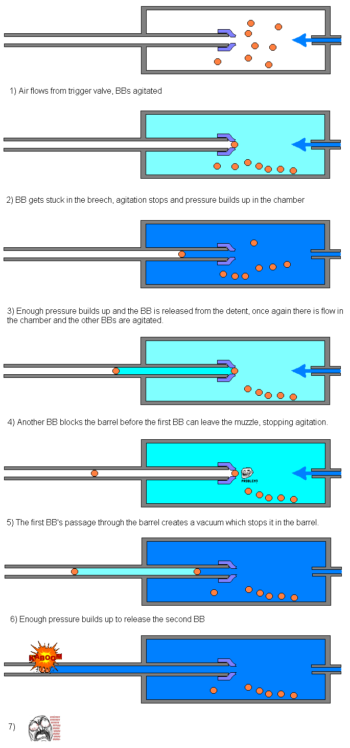

JSR, the physics does not work as drawn.. Sorry.
The reality.
First BB enters the barrel and as it move into the barrel, air under pressure follows it in. Let's say it is a very low 15 PSI.
Second BB blocks the barrel. First BB does not "Stop due to vacuum". It begins to slow down when the air trapped between the 2 BBs expands out to double its volume at or 0 PSI. At double this new distance the pressure has now dropped below 1 atm to -7PSI and has most likely exited the barrel.
If the second BB enters the barrel before the first BB exits, the same mass of air is still between the two. As the space decreases, the pressure increases. The in barrel collision is highly unlikely. The 2nd BB won't acellerate enough with the rising head pressure on it.
I have done some low pressure shots to show the projectile rate of acceleration, and the much lower rate of deceleration on negative pressure.
Technician1002 wrote:JSR, the physics does not work as drawn...
The reality though is that in-barrel collisions with detents do happen:
This is the only explanation I can think of at this point.
I think I have seen that photo before. I think that was a hybrid barrel and that is detonation damage.
Technician1002 wrote:I think I have seen that photo before. I think that was a hybrid barrel and that is detonation damage.
As the person who took the photo, I'm pretty sure it isn't ;)
Granted that particular one wasn't from a detent BBMG, but it's a phenomenon I've observed in various prototypes with an airtight detent, for example a shattered epoxy cast barrel at the muzzle end of my 3/8" HPA launcher, and barrel bulging is also the reason updates on this 3mm project stopped abruptly :roll:
