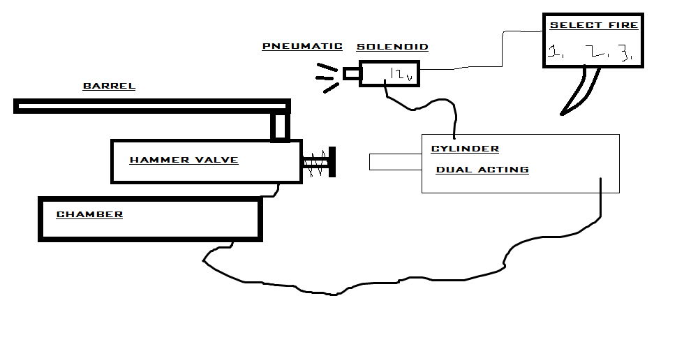

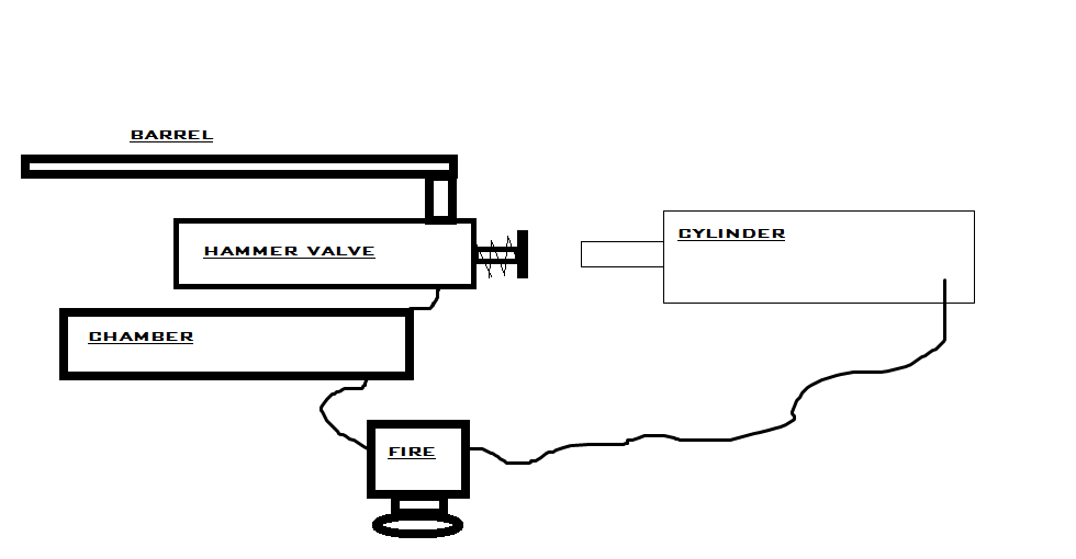

Ok I'm about to order the solenoid, jack are you sure it's strong enough? I still need a hit of 2kg for the valve to work safely and reliably. Just to make sure I won't be wasting money.
Goats spudz
- Specialist 4
- Posts: 458
- Joined: Tue Aug 02, 2011 12:31 pm
wouldn't it be simpler to connect the chamber to a pneumatic cylinder with a solenoid or push button valve to fire it, so it hits the hammer valve and feeds the air back in to the tank?wyz2285 wrote:Ok I'm about to order the solenoid, jack are you sure it's strong enough? I still need a hit of 2kg for the valve to work safely and reliably. Just to make sure I won't be wasting money.
http://www.airlines-pneumatics.co.uk/we ... =S03011805

If I uses electric hammer, I could make selective fire, like single/semi/full auto

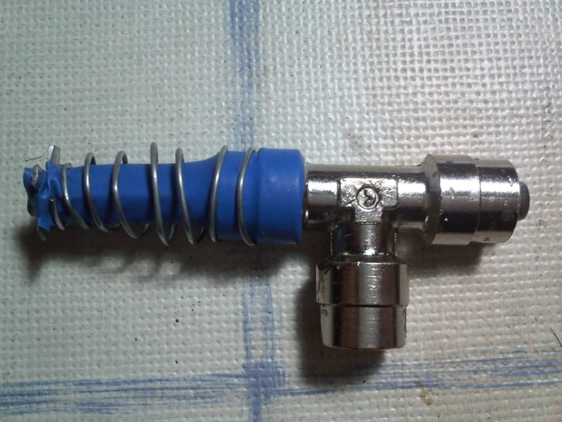

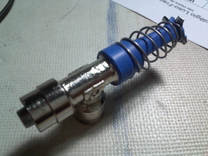

here is a pic about the finished valve.

aah me sees but... for that 3kg explosive kick... cylinder me thinks!wyz2285 wrote:If I uses electric hammer, I could make selective fire, like single/semi/full auto

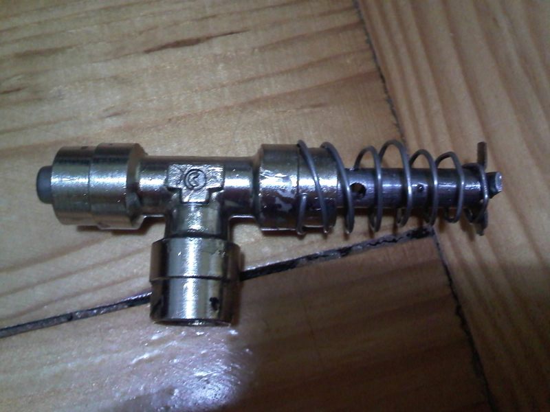

Have you been able to get your valve to seal yet have a manageable amount of friction? without that I don't think you'll be more successful than jack at this design. have you considered a valve setup like the one's in electromagnetic paintball markers
you could do the same thing only you'd replace the air cylinder with a solenoid overall the valve should have less friction
- Mr.Tallahassee
- Posts: 364
- Joined: Sun Jul 10, 2011 2:35 am
I'm wondering why the spring looks so heavy. This shouldn't really need a heavy spring to operate. You should use only enough tension to keep the valve from bouncing. That will minimize the force needed to open the valve and will improve power at the same time.

I only need 0.5 kg to open the valve, low friction because i used o-rings to seal, no leaks
when the coil arrives i will make some test to show you guys

Your valve will leak through the " exhaust" hole at the moment it passes the o-ring.
You'll need two to keep it from blowing air straight into atmosphere.

Found out that I need to protect the valve from dust, so I cut a section of a small ballon, worked nicely
