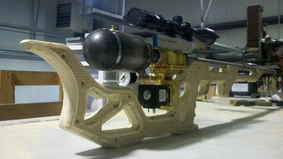

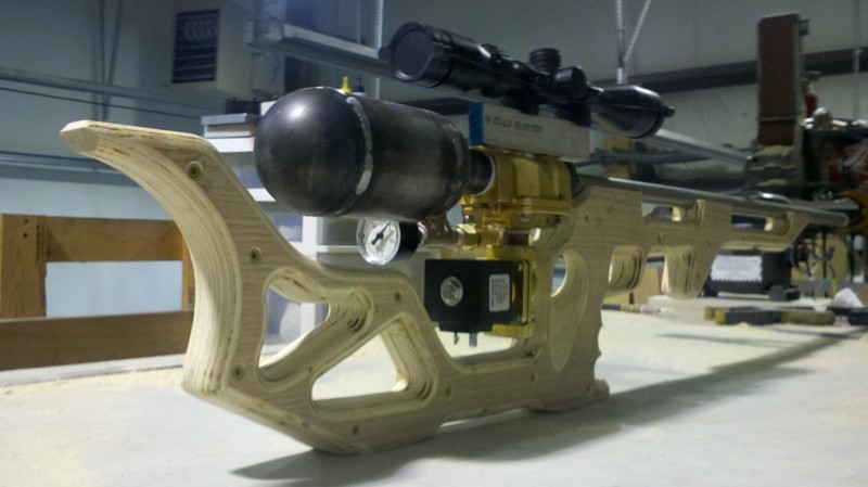

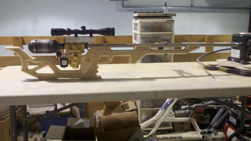

So, I decided to make it a high performance cannon. It will look cool, but not scale. I am focussing on performance, period. Looks will come second. I will make a decent stock and trigger assembly for it this month. For now, I have bench tested the functional components. Here is the setup;
3 to 1 tank to barrel ratio
1/2 inch barrel (.60 caliber)
1 inch Granzow fast acting valve piloted by a 1/2 inch direct acting Granzow valve and an upgraded high power solenoid
3 foot aluminum barrel
This will obviously be an electrically actuated gun.
I have charged the tank to 600 psi and dry fired it. I also charged it to 500 psi and fired a 8 gram slug through two sheets of 1/16 inch aluminum diamond plate. The gun is very loud for a small bore.

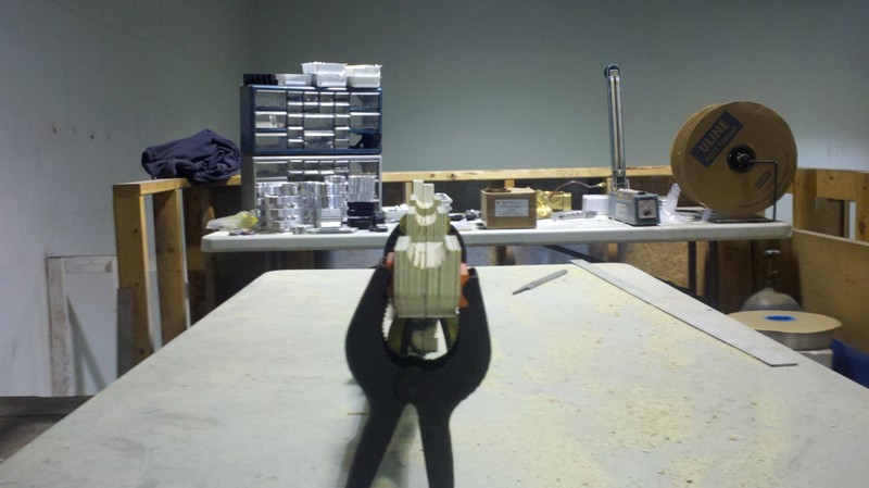

I decided on a stock style.....

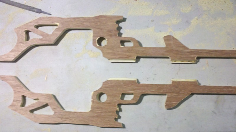

I picked up some 10 ply oak plywood today to double laminate into 1.5 inch thick panel. I will carve a radical stock out of that.

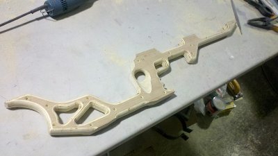

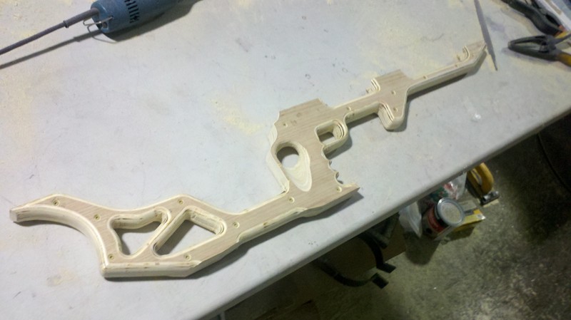

Here is the stock (so far). It consists of two layers of 10 ply oak laminate 3/4 inch plywood joined together. The barrel chanel was made by routing each panel separately then joining them together. The stock will be very lightly stained, then varnished. The tank will be powder coated black and the barrel will be anodized black. There will be various scope mounts, barrel brackets and the like that will be machined aluminum, anodized black. I have tested the system up to 600 psi. I would like to run 800 psi through it. We shall see!
I will post more pictures as the gun evolves.
Matt
