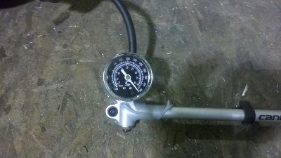

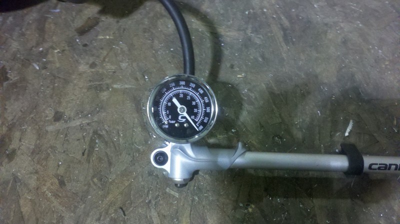

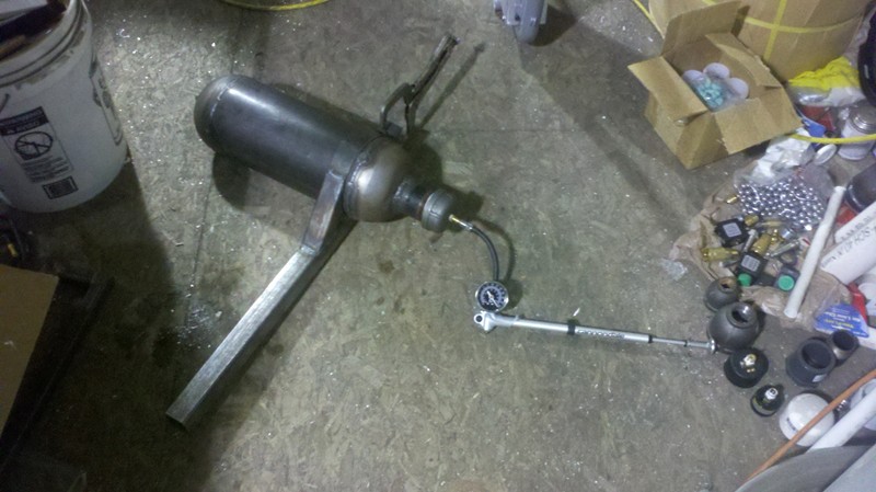

OK, I decided to test my tank with my shock pump. I filled the tank completely with water. It was so full, the valve fitting was squirting as I tightened it down.
Anyway, I filled it and pressurized it to 625 psi. I left it for 10 minutes and drained the tank. Now it is at the powder-coater to be coated a nice semi-gloss black.
I am thrilled with this. Now I feel safe charging it to the 300 psi I have been aiming for. Heck, 400 psi doesn't seem that bad now that it has held over 600.
Matt
