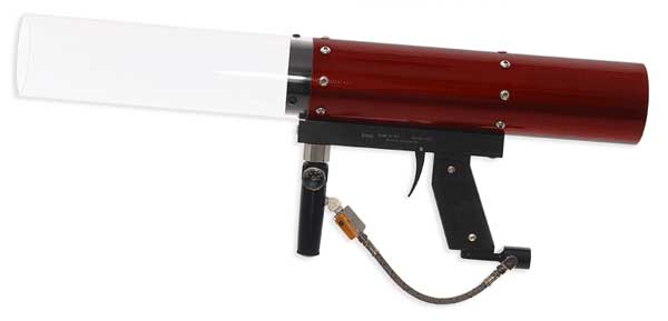

Below is a picture of the Bleacher Reacher Pro, $1,600. Supposed to shoot t-shirts 100 yds. It uses paintball CO2 tanks. I'm tring to make something similar (also with a clear barrel), but a lot cheaper.
- bleacher_reacher.jpg (7.62 KiB) Viewed 2304 times

I've seen the claim, but have seen no documented evidence it reaches that far with a rolled up shirt. I've seen one in use. Typical use at a game is 100-250 feet. 300 yards may be a rare exception at high elevations in thin air, but not at sea level. They most often hit the 200 section up to the box seats, but rarely above that into the 300 section.
This is typical performance. The 300 section is not 100 yards.
Another one
Another one

I don't like false claims.
That's typical in a lot advertising though. If I can get to 250 feet will be good enough. I can claim 300 feet too! But I won't.
When I get this thing built maybe I can tweak and squeeze out the remaining 50 feet somehow.

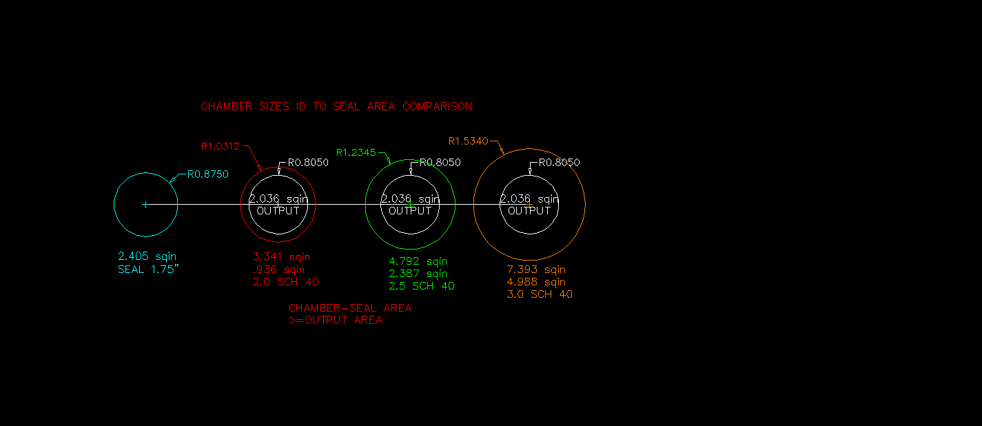

After starting to do a 3D model of your design I came up against some problems.
With an output of nominal 1.5 inch port and and a port seal of 1.75 inches you will need at least a 2.5 inch nominal chamber and a 3.0 inch may be better.
Look at this drawing for a comparison.
This is why Tech is always stating use a larger diameter chamber that is shorter. Example is his use of propane tanks. Short and fat!
- Chamber ID to Seal OD comparison
- GOM-Size-Ratio.png (11.34 KiB) Viewed 2284 times

So you say you are trying to reach out for commercial use? Glad to hear I'm not the only one.
I would say your design would work, but you may have some problems with getting the tshirt to fly the distance needed. Try a light weight and soft sabot, like foam, to help get the acceleration, then have it peel apart almost instantly after leaving the barrel to avoid it hitting a spectator.
You are limited by the "steel" sizes available and that being 2 to 1.5 maximum for higher pressures.
You can get larger in the 150psi rating standard pipe.
But then that becomes a "liability" issue unless you limit it to 150psi max.
