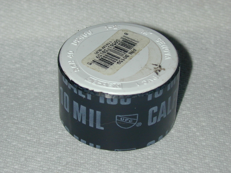

Ok, I guess it's back to the old "gut" build. Where I build it the way my gut tells me to build it.
It's worked before, hopefully it will work this time.
I'd rather be using a 3/4" or 1" barrel, inside the 2" chamber.
But I have limited myself to the 1/2" barrel because I have such an easy, replenishing, and basically to me... free, source of dart material for the 1/2" barrel.
I have already begun the build, and have desided to go with a piston that rides in the chamber itself, instead of trying to work a 1" piston into the equation. I'm already going to have alignment/squaring issues at the barrel end of this thing. No need to introduce them at the pilot/barrel seal end.
Here is the beginning of that piston. A 1-1/4" end cap. Wrapped with enough tape to make a slightly less than snug fit. (Large enough gap to allow air past on inflation, but small enough not to just allow all the air back past it when the pilot chamber is emptied.)
The tape used is 10mil plumbing repair tape. If that proves to be not suitable, I'll use gorilla tape, instead.
A short, (longer than the cap itself.), piece of 1-1/4" pipe will be cut and glued into the cap, and then filled with foam or something, to try to cut down on the pilot volume.
More pics as I progress.
