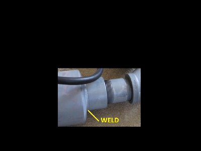

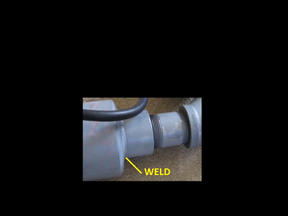

AircannonSweden wrote:I just came up with an idea :P Don't take this serious,i made it in like 5 minutes and if you have a question: ask
Personally I think that is more work and a less flexible design than just using a tank and a merchant coupling.
You need to make a cut on the tank and a cut on the nipple.
With a merchant coupling you only need to make one cut and that is on the tank.
Adding a hole for a fill valve at the back of the tank is not a good idea because it reduces the strength integrity of the tank.
Here a 1-1/2 inch merchant coupler welded to a 4.25 inch diameter fire extinguisher.
