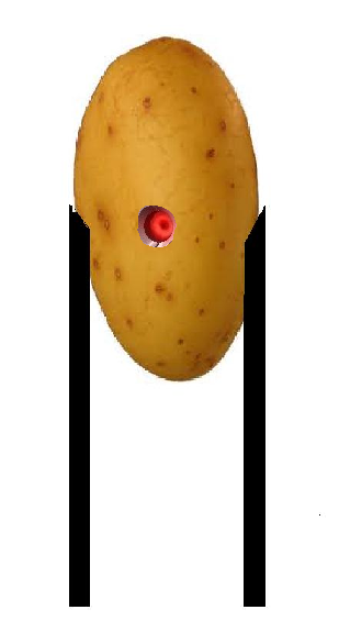

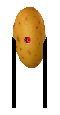

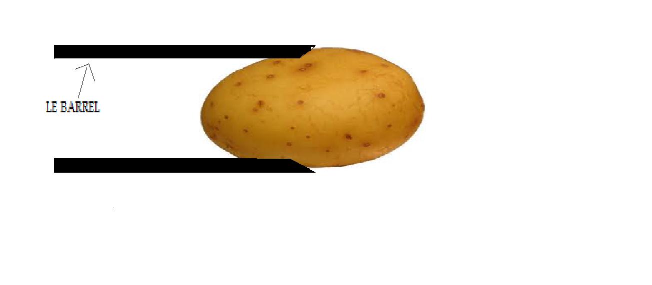

try put a internal chamfer on the barrel barrel so you cut over size spuds that fit the bore tighter.

I don't understand.Crna Legija wrote:try put a internal chamfer on the barrel barrel so you cut over size spuds that fit the bore tighter.

ninjamonkey127 wrote:I don't understand.
- untitled.j.JPG (26.84 KiB) Viewed 4704 times

Oh, now i see. I'm gonna give this a try.Crna Legija wrote:ninjamonkey127 wrote:I don't understand.

Thank you Crna Legija for the advice! It definitely worked. But now i have a broken fan and i think i have a leak somewhere. When i tried stuffing a potato down the barrel for the second time, i think there was too much air pressure building up in the chamber and it broke the fan from that square plastic thing it's in. I need to make a mental note to take the cap off the back next time i load the gun. Does a fan really make a difference?

The main problem was the spud night getting a tight enough fit when it goes down the barrel. But that problem and the leak has been fixed. I also put a new fan in the chamber today.
