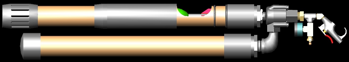

A QEV is a right angle valve, so an inline setup is not really what it's made for.
I'd reccomend a design like this
Image[/url]

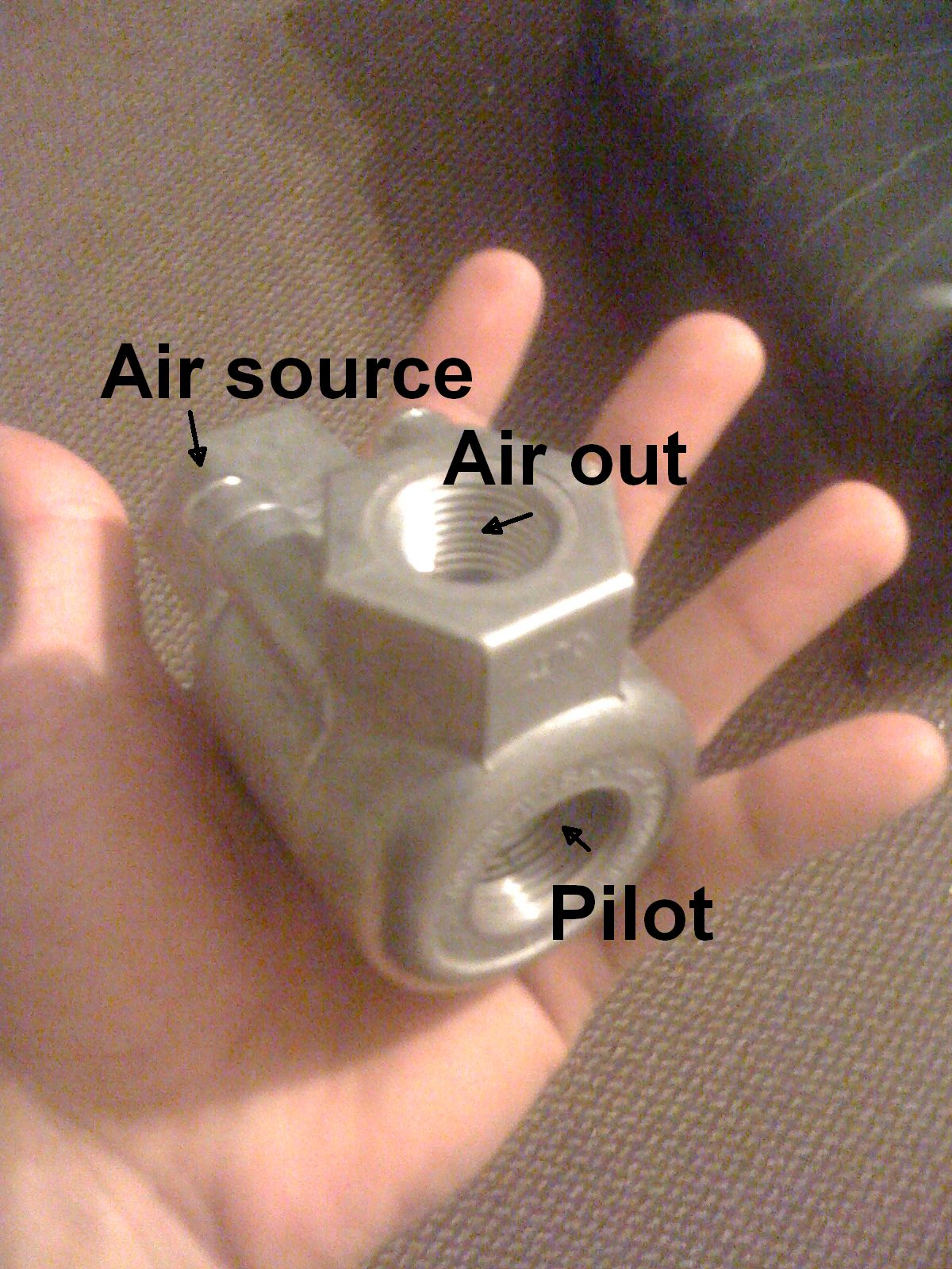

Is this the proper way to run it? If it is, I'll need to do something else. It REALLY needs to be inline. Unless I could hide some 90's in the grip or something.
You need something like this:
Or if you're keeping to 125PSI and under, just go with a 1" sprinkler valve. Or have I missed something and you have already discussed this option?
edit: in reference to your picture 'air out' is the chamber, 'air source' is the pilot and 'pilot' is where the barrel goes.
As for my picture above, you would remove the solenoid and modify the top so you can attach a pneumatic pilot valve. I see you said sprinkler valves are bulky; while they're larger than 3/4" QEVs they're about as small as you can get for in-line valves like that.

Gotcha. Yea. Mixed that up real good. haha
I'll see about using what you suggested there. Its basically a diaphragm valve right?
I originally got the QEV to do inline, I was mistaken. I got that QEV4 for like $20 or something, so not a huge loss. LOL
