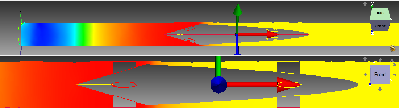

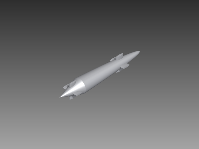

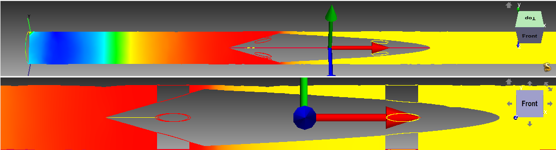

But they require much higher speeds initially i am currently playing with ideas in Autocad CDF i will post results shortly
Edit:
After several different destines this is the one that did the best
Edit:
- projectile.png (15.78 KiB) Viewed 5570 times

Hm, thank you!
It kinda makes sense that shape, because the "pressure point" is so far forward, by the time the gas ignites it has a lot of surface area to push on, unless I'm thinking of it the wrong way.
I'm still hoping those guides can double as fins

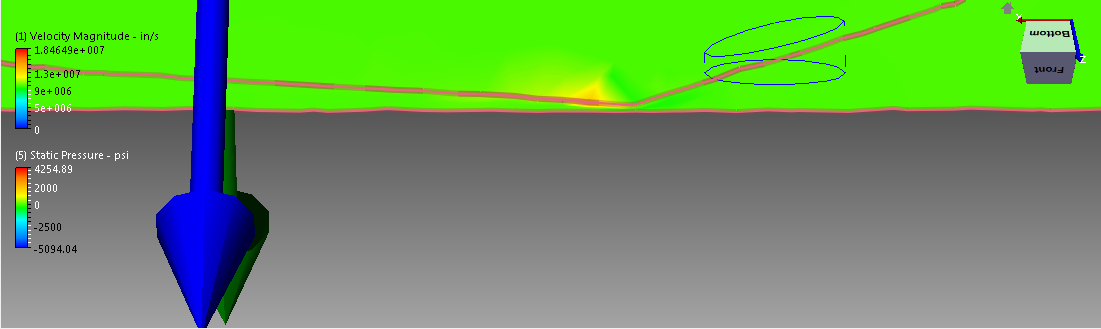

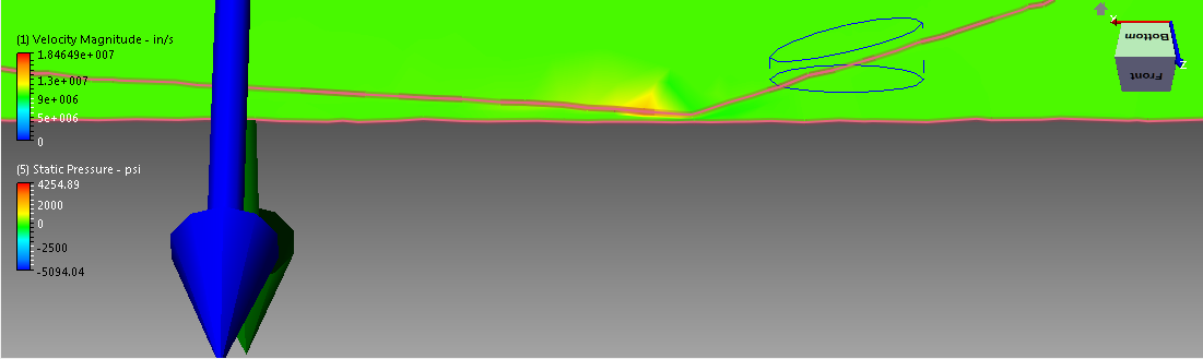

idk i will do some free flow sims today

It has charastics of both but more similar to scramjet
Edit: It looks like it ill flw well with the fins
But it will make an epic shockwave
