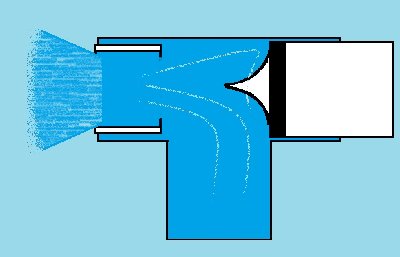

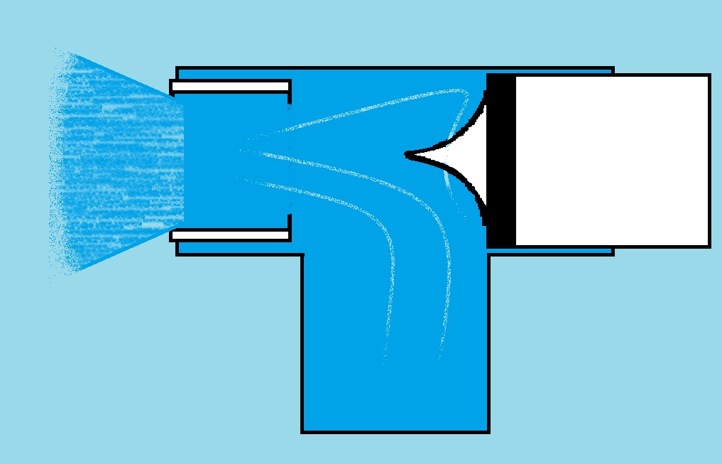

Taking up dead space/turbulance is what a cone does if it has the right shape.
That means it actually increases flow. ( or rather, without it, flow is already restricted)
The front of the piston when fully open should curve from the inner walls of the 90 degree 'in"port to a sharp point in the center of the outport without sticking in, or falling short for that matter.
The outport should sit forward a tiny bit according to the same principle.
Look at the picture and think about it for a second.
This is what an optimised T-valve should look like:
- Technician1002
- Posts: 5189
That design works for a coaxial valve with air entering from all sides, but falls short with air entering from only one side. You would want to modify it for single side air flow if used in a T.
