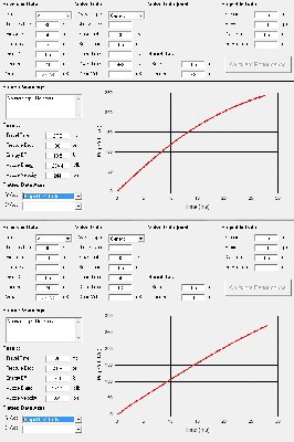

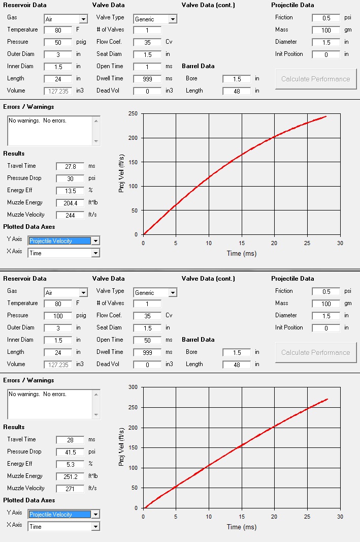

Here's a little GGDT simulation for a given launcher, a mid sized coaxial pneumatic.Technician1002 wrote:I think the creation by D Hall speaks volumes on the subject.
In the first scenario, it's running at 50 psi with a valve opening time of just 1ms, which gives us a muzzle energy of 204 ft lbs.
Doubling the pressure to 100 psi, and dramatically slowing down the valve to 50ms gives us a muzzle energy of 251 ft lbs, almost 25% more power.
Granted it's not very efficient, less than half that of the launcher at low pressure, but if you're seeking power, moar pressure is usually a good answer
That being said, you should aim to optimise all your parameters, so a faster valve is still a very good thing.
