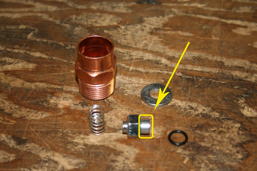

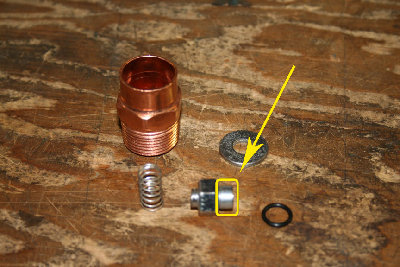

Hey Guys,
In the stirrup pump pic... what is the hose attaching setup there? I'm trying to figure out what kind of hose to buy for the pressure and how to attach it to the piping.
Thanks!
Thanks!
http://www.ebay.com/itm/New-Paintball-C ... 5af1956ecd
For just over 20 bucks you get a hose, check valve and male/female quick connect, fittings are normally 1/8" NPT.

Thanks for the suggestion, JSR. I may go that route. Question about the DIY check valve in the stirrup... Do you think it can handle 500 psi?
A North African DIY check valve or a European DIY check valve? Since it's the pressure that holds it shut, I would say it can take 1000 psi easily.air_dannon wrote:Question about the DIY check valve in the stirrup... Do you think it can handle 500 psi?
